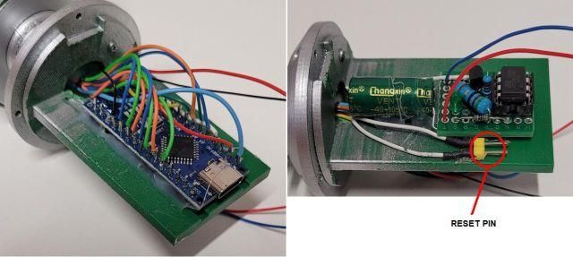

The RoboPet saves the days every 24 hours and stores its age in the Arduino's EEPROM. If it dies, you won’t be able to run it again. You need to unscrew the bottom and reset it on the reset pin. The display will show how long it survived.

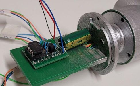

Power Bank Note:
Most power banks turn off if they draw less than 100mA after about 30 seconds. To prevent this, I added an Attiny-13 chip that draws about 80mA for 1 second, every 25 seconds via an NPN transistor and a 1Watt 50 Ohm resistor.
If you plan to use a USB power point continuously, you can skip this part.

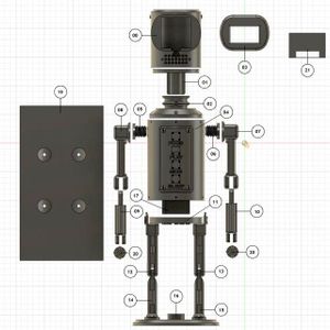

Step 1: Print STL Files
Print all STL files and paint them as desired.

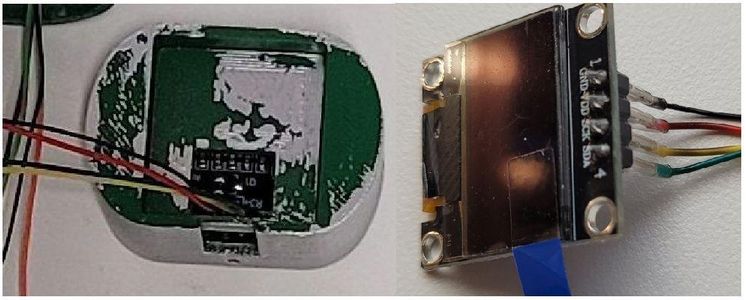

Step 2: OLED Display
Solder wires to the OLED display and mount it to the OLED-holder.
Secure the back with a bit of glue.

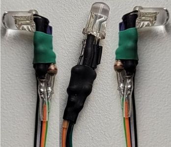

Step 3: LED
Solder the resistors to the 3 RGB-LEDs, and attach approx. 15cm long wires to the end of the resistors. Secure the solder points with shrink tube and hot-glue.
LED PINs Red 270Ω
LED PINs Blue 220Ω
LED PINs Green 220Ω

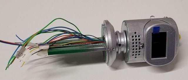

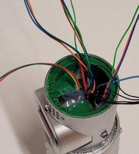

Step 5: Mount Head
Mount all the parts (LED_Nose, LED Ear Left, LED Ear Right, Buzzer, OLED Display Holder, Info Push button) into the head and secure them with glue if necessary.

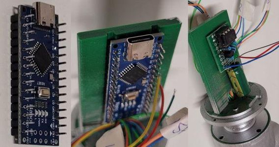

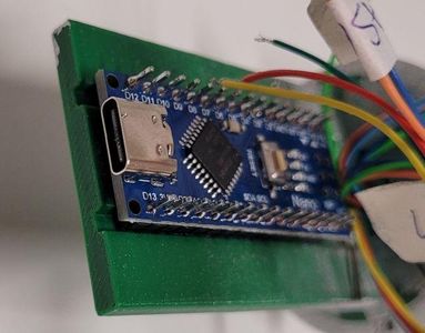

Step 6: Arduino & ATtiny13
Download the program code for the Arduino and Attiny13:
- Arduino Code: .ino file for the Arduino IDE
- Attiny13 Code: .bas file for the Bascom compiler
Program the Arduino Nano using the Arduino IDE, and if using a power bank, program the Attiny13 as well. If you’re unfamiliar with programming microcontrollers, many tutorials are available online.
Step 7: MCU Holder
Attach the shoulder, neck, and MCU holder to the head using 1.5mm x 10 screws and superglue.
Step 8: Mount Electronic

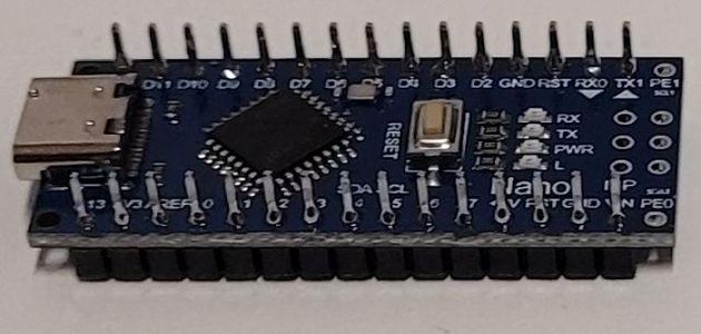

Use a hot glue gun to secure all electronic parts to the MCU holder, Arduino Nano, and if needed the "NoTimeout module" for the Power bank.
Soldering the pins this unusual way to the Arduino Nano, makes it easy to glue the Arduino onto the Arduino-Holder. See Picture.

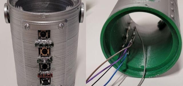

Step 9: Mount Body
Mount the 4 Tactile-button to the body and solder approx. 15cm long wires to the connections.
Step 10: Soldering
Solder all wires leading from the Head to the Arduino, according to the wiring diagram.

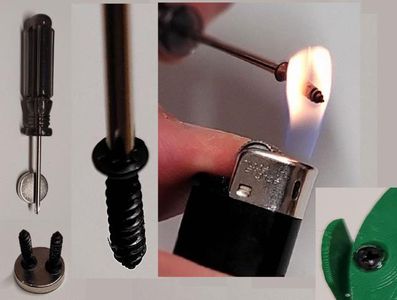

Easy way to use Self-tapping screws in 3D prints.
Magnetise screwdriver and the screws, by holding screwdriver and screws for a few seconds to a strong magnet. Stick the screw to the end of the screwdriver and heat it up with a lighter for 7 to 10 seconds. Then press it into the 3D print.
