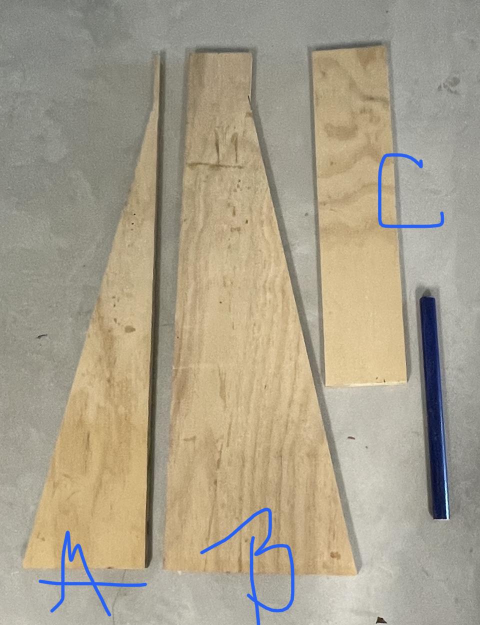

Step 1: Mark Wood Scraps and Cut the Components
MAIN BODY UPRIGHT WALL AND RACETRACKS:
Transfer the layout onto the plywood scrap "A" using CUT LAYOUT Figure 1. (Part H of project - lower rail)
Transfer the layout onto the plywood scrap "B" using CUT LAYOUT Figure 1. (Part A of project - upright)
Transfer the layout onto the plywood scrap "C" using CUT LAYOUT Figure 1. (Part I of project - base)
I used a hand saw to make the following cuts (straight).
a. Part H: cut off 12". The final piece has a 2 1/4" to 1/4" taper.
b. Part A: The scrap piece from the "one board contest" will be used as is.
c. Part I : This scrap piece is to be cut to 12" length.
d. Parts B - G: From an 8 foot piece of 1- 5/8" x 1/2" Screen Molding
e. Parts B-1 to G-1 From 3 foot piece of 5/16" wood dowel.
f. Various pieces of 3/16" wood dowel for retainers and decoration.
