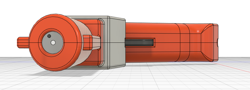

I will now go into detail about how I designed the Light Zapper. I will break it into two sections: the body and the trigger. If I had more experience using meshes, I probably could have come up with something more intricate. Even still, I believe the final product accurately reflects the look of a Nintendo Light Zapper and should be fantastic for 3d printing.
At the time of writing, the Autodesk Gallery is temporarily unavailable, so to view the design use this link: https://a360.co/3UoEt4W. I also have the Fusion 360 design file attached below.
To attach the circuit boards to the light zapper, I recommend just using hot glue.

Step 3: The Body
I tried many different methods of creating the body but settled on extruding the central handle part, then extruding a cylinder. Because I do not currently possess a Light Zapper, I utilized a Nerf gun I had lying around to create the measurements for the handle to provide a comfortable fit in hand.
- I first created a rough sketch of the handle of the Nintendo Light Zapper.
- I then sketched a circle on the handle and extruded it for the barrel of the zapper.
- I then blended the cylinder better by extruding a square into the barrel. I also added a ridge down the bottom of the barrel to stick with the theme of the Nintendo Light Zapper.
- Because I feel there can never be too much fillet, I added fillet to round the rough corners.
- I then cut 2mm holes to keep everything together once I split it in half.
- To mimic the design of the Light Zapper, I added a top and bottom wrapper.
- Until then, I have been using the default steel material, so I changed it to ABS and the main body to orange.
- Lastly, I split the main body in half. I then hollowed it out to make room for the electronics and trigger.
- Later on, I added a hole in the bottom for a USB-C cable to go through.
- Then to finish it off, I filleted everything because why not?
