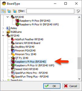

Step 2: Start Visuino, and Select the Raspberry Pi Pico (RP2040) Board Type

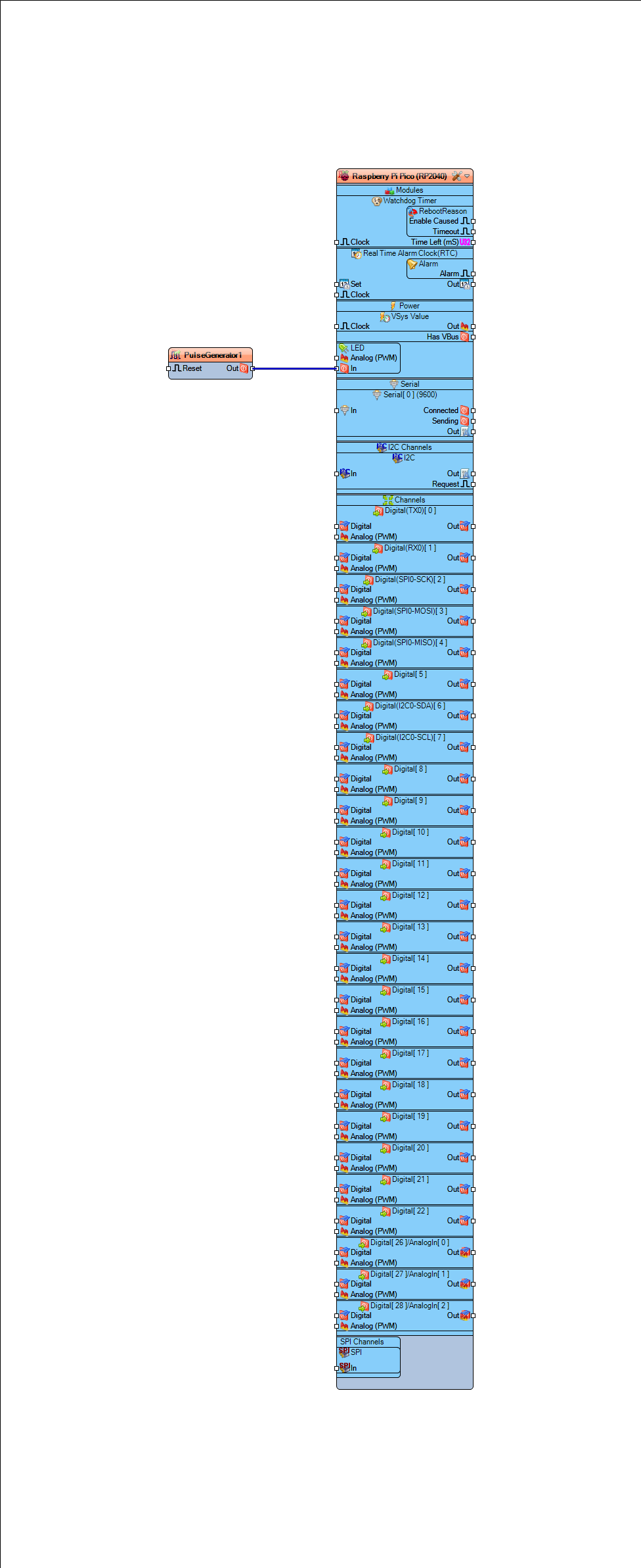

Start Visuino as shown in the first picture Click on the "Tools" button on the Arduino component (Picture 1) in Visuino When the dialog appears, select "Raspberry Pi Pico (RP2040)" as shown on Picture 2

  • Add "Pulse Generator" component
  • Connect "PulseGenerator1" pin [Out] to Raspberry Pi Pico (RP2040) board > LED >Digital pin [In]

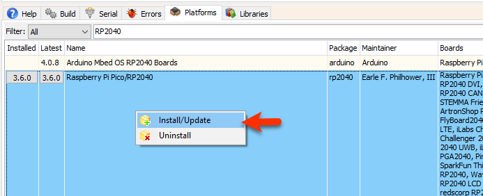

In case Visuino would not upload the project, in Visuino click on the bottom tab "Platforms" and in the search box type "RP2040" and check if the "Raspberry Pi Pico/RP2040" is installed (Picture 1), if it is not installed or the Installed version is lower then the Latest version right click on it and select "Install/Update" (Picture2).
Note: sometimes the files could be in conflict, if you still can not achieve to upload the project try to uninstall other files for Pico board (Picture3).
