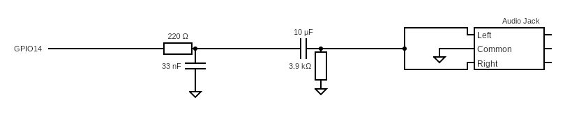

Step 1: The Circuit
The circuit is essentially the same as the recommended raspberry pi audio circuit (see in hardware design datasheet and this blogpost and comments). The main difference is I don't use the resistor divider to bring the voltage down to 1V peak to peak. This is taken care of in software. I also just used the capacitors I had that were closest in value. If you want better bass on headphones you might need to increase the value of C2 to 47 microfarads. This shouldn't matter for line out. The low pass filter has a slightly lower capacitor value but that is to compensate for the fact that in the raspberry pi design the resistor divider lowers the effective resistance and therefore needs a bigger capacitor for the same frequency response.
