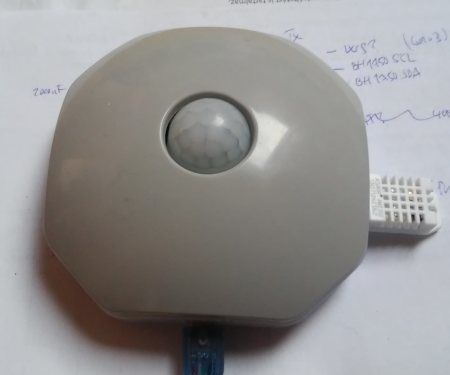

Step 1: Assembly
Let's get started with a simple setup, using a temperature and a light sensor:
- Raspberry Pi Zero W
- 8GB/16GB Class10 microSD memory card
- Micro USB 5V2A Wall Charger
- DHT22 temperature and humidity sensor
- 4.7 kOhm resistor
- BH1750 light intensity sensor
- some jumper cables
- plastic box
Assemble it according to the fritzing.

Click an Edit button, select the necessary DHT22 and BH1750 plugins and set parameters according the fritzing. The DHT22 1st GPIO is GPIO22 and oversampling is generally a good idea as this kind of sensor is very sensitive of accurate timing. (remember that DHT communicates with one wire, but it is not 1-Wire compatible!)
The BH1750 is an I2C sensor, the I2C address can be selected from a select, the default is 0x23, oversampling is not necessary as the I2C communication is quite solid.
It can be selected that on which controller, which IDX and what intervals the sensor reading has to be sent. The Formula field is compatible with EasyFormula, and local ESPEasy compatible rules can be specified at the Rules menu.
This is the short story of making an RPI based multisensor, there are many options and combinations, feel free to try them in the spirit of the DIY!
