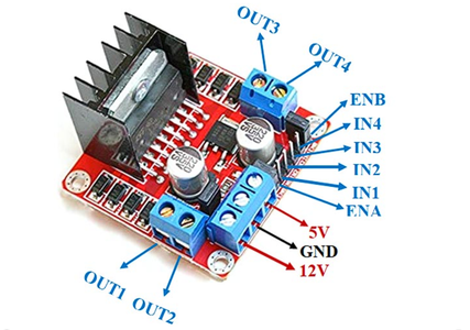

The Only Problem i faced while Tinkering the circuit is that the loose connections with the Motors on the Motor Driver, Please be sure that you do not commit the same Mistake as Me, these Actuators can be used in any required Electro-Mechanical Projects as they are easy to operate using the Arduino Microcontroller and L298N Motor Driver.
Another problem i faced after the pairing of all the devices together is that, Motors were not running up to the Desired Output as Set-Up in the CODE, After Brainstorming over this issue i got back to the Basics of of INPUT VOLTAGE(5V),GROUNDING of L298N and Arduino as there must be a common ground in Between them at the Arduino Ground Pin with Connecting Wire(Male to Male). The Image of this grounding is attached as a solution for Resolving the Problem.

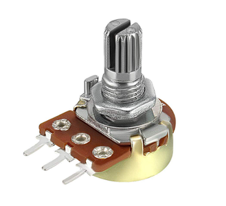

2.Potentiometer(b100k):

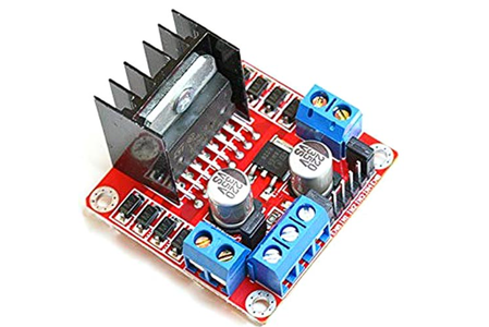

3.Motor Driver L298N:

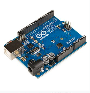

5.Arduino Uno:

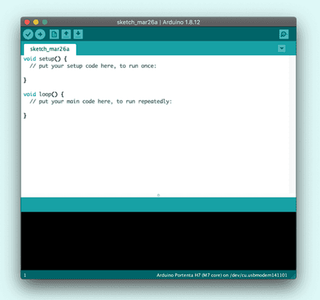

6.Arduino IDE:

Step 2: Potentiometer
A B100K Potentiometer(Variable Resistance) is a type of adjustable resistor commonly used in electronic circuits to vary voltage and control various functions. The "B" indicates that it has a linear taper, meaning its resistance changes evenly as you turn the knob or slide the lever. The "100K" signifies that the maximum resistance it can provide is 100,000 ohms. It has three terminals: two connected to the ends of a resistive element and one to a wiper that moves along this element, allowing you to adjust the resistance between the wiper and each end. This makes it useful for applications like adjusting volume in audio equipment, tuning the output in power supplies, and calibrating sensors, where precise and consistent control is needed.

Step 3: L298N Motor Driver
The L298N is a popular dual H-bridge motor driver module that allows you to control the direction and speed of two DC motors independently. It is widely used in robotics and other applications requiring motor control due to its versatility and ease of use. The module can handle motors with voltages from 5V to 35V and currents up to 2A per channel. It has four input pins for controlling the motors, allowing you to set each motor's direction and speed by using PWM signals. Additionally, it has onboard protection features like thermal shutdown and current sensing, making it reliable and safe for various projects. The L298N also comes with an onboard 5V regulator, which can be used to power other components in your circuit. This makes it an essential component for hobbyists and professionals working on projects that involve motorized movement.

Step 4: Programme
// Define pin connections for Motor A
const int enA = 9;  // PWM pin to control speed of Motor A
const int in1 = 8;  // Pin to control direction of Motor A
const int in2 = 7;  // Pin to control direction of Motor A
// Define pin connections for Motor B
const int enB = 10; // PWM pin to control speed of Motor B
const int in3 = 5;  // Pin to control direction of Motor B
const int in4 = 4;  // Pin to control direction of Motor B
// Define pin connection for Potentiometer
const int potPin = A0;  // Analog pin to read potentiometer value
void setup() {
  // Set all the motor control pins to output mode
  pinMode(enA, OUTPUT);
  pinMode(in1, OUTPUT);
  pinMode(in2, OUTPUT);
  pinMode(enB, OUTPUT);
  pinMode(in3, OUTPUT);
  pinMode(in4, OUTPUT);
  // Initialize serial communication for debugging
  Serial.begin(9600);
void loop() {
  // Read the potentiometer value (0-1023)
  int potValue = analogRead(potPin);
  // Map the potentiometer value to a range of 0-255 for PWM
  int speed = map(potValue, 0, 1023, 0, 255);
  // Debugging: print the potentiometer and speed values to the serial monitor
  Serial.print("Potentiometer Value: ");
  Serial.print(potValue);
  Serial.print(" | Motor Speed: ");
  Serial.println(speed);
  // Move Motor A forward
  digitalWrite(in1, HIGH);
  digitalWrite(in2, LOW);
  // Set speed of Motor A
  analogWrite(enA, speed);
  // Move Motor B forward
  digitalWrite(in3, HIGH);
  digitalWrite(in4, LOW);
  // Set speed of Motor B
  analogWrite(enB, speed);
  // Run the motors for 3 seconds
  delay(3000);
  // Stop the motors
  digitalWrite(in1, LOW);
  digitalWrite(in3, LOW);
  // Wait for 1 second
  delay(1000);
  // Move Motor A backward
  digitalWrite(in2, HIGH);
  // Move Motor B backward
  digitalWrite(in4, HIGH);
  delay(3000);
  // Stop the motors
  delay(1000);
Step 5: Hardware Connection
These are Hardware Connections are explain in a upward explanation and programme code.
