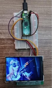

Introduction: RPi Pico – 3.5 Inch (320x480) HVGA TFT LCD (ILI9488) – Bitmap Image Photo Frame – Internal Flash
The photo frame experimentation is about interfacing 320x480 HVGA TFT LCD with Raspberry Pi Pico. This experiment displays, internally stored images on TFT LCD screen. It uses python program for implementing file read, bitmap image handling functionalities.

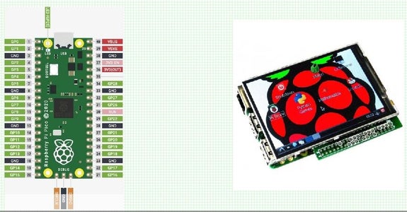

Step 4: Schematic
The TFT LCD (3.5 inch, 320x480 pixel, ILI9488 LCD controller), is used for this instruct-able.
The LCD is easily interfaced with RPi Pico SPI bus, and it needs minimum of four Digital IO lines.
The ILI9488 LCD Controller is a 16.7M single-chip SoC driver for a-Si TFT liquid crystal display panels with a resolution of 320(RGB) x 480 dots.
The ILI9488 is comprised of a 960-channel source driver, a 480-channel gate driver, 345,600 bytes of on chip GRAM for graphic data of 320 (RGB) (H) x 480 (V) x 18 dots.
The LCD operates at 3.3 Volt Logic.
The ILI9488 supports 8-colors display and sleep mode power management functions, ideal for portable products where battery power conservation is desirable, such as digital cellular phones, smart phones, MP3 players, personal media players and similar devices with color graphics displays.
RPi Pico SPI port is connected to the LCD (GPIO6 - SCLK, and GPIO7 – MOSI).
RPi Pico GPIO pin GPIO0, GPIO1 and GPIO2 are connected to CS, RST and DC\RS pin of TFT LCD.

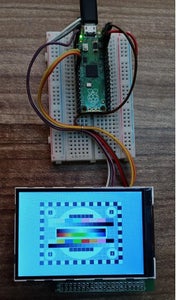

Step 6: Python Program – 320x480 TFT, Bitmap File Handling
Open the RPi Pico as drive, and then copy the bitmap files into root directory.
The timer_one is initialized and callbacks the “BlinkLED” functionality for toggling on board LED at 500mS duration. (frequency = 1)
The TFT LCD class provides basic firmware functionalities like Init, ResetDevice, WriteDevice, WriteDataToDevice, WriteBlock and FillRectangle.
The python program, initializes ILI9433 TFT LCD with SPI interface.
The python program reads the bitmap files, and screens one after another at 3 seconds interval.
Demonstrates the use of 320x480 HVGA TFT (ILI9488) TFT, initialization and internal flash photo frame application Draw Bitmap files (BMP) on screen * The Raspberry Pi Pico pin connections for TFT is given below: # TFT Power Pins * TFT VCC pin to 3V3 * TFT GND pin to GND # TFT SPI Pins * TFT SCLK pin to GPIO6 * TFT MOSI pin to GPIO7 * TFT CS pin to GPIO0 # TFT Control Pins * TFT RST pin to GPI01 * TFT RS\DC pin to GPIO2 Name:- M.Pugazhendi Date:- 24thAug2021 Version:- V0.1 e-mail:- muthuswamy.pugazhendi@gmail.com '''

The project is successfully completed with Raspberry Pi Pico and 320x480
TFT LCD shield 320x480 HVGA shield represent flexible in expensive display technology and can be used for many embedded projects as mixed image and alpha numerical display. It consumes less power.
