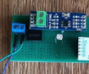

Step 3: Wiring the Arduino
In the image above you can see how to wire the arduino to the RS485 interface. The second RS485 represents a USB to RS485 adapter.
