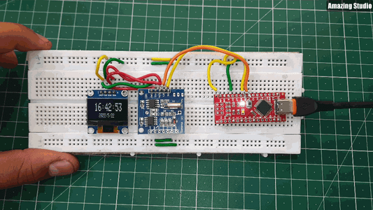

Step 4: Circuit Diagram:
Both LCD and RTC are connected through Inter integrated circuit protocol, having different address for both. SDA pin is data pin which is connected to A4 of Arduino and SCL is clock signal connected to A5. Circuit can be supplied using 5volts @250mA.

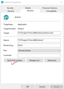

SSD1306 library is available in Arduino IDE library manager, get RTClib.h file from here and copy this in your Arduino libraries directory after extracting.
Path to Arduino Directory is the file location:
Step 8: Working:
