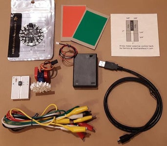

- Circuit Playground Express loaded w/ CircuitPython and RTPlayground2 (details in this instructable)
- LCA710 Solid State Relay
- 6 alligator clips
- Battery holder and 3 AA batteries (rechargeable)
- JST-PH 2 pin - Female cable
- USB to micro Usb cable
- 1K resistor
- 170 point breadboard
- 2 pieces of cardboard and red and green origami paper
- hookup wire
Optional:
- K'nex mounted servo as described in Step 7 of my Bobble Car Instructable
- Cardboard K'nex motor adapter described in my Computer Control Your K'nex Instructable
- Misc. collection of K'nex parts

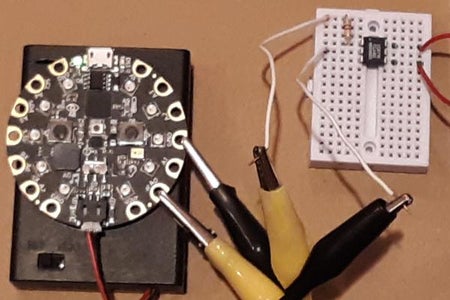

Step 1: Wire Up the LCA710 to Build a Solid State Relay Board
If you already have an assembled LCA710 Solid State Relay Board, skip to the Using the LCA710 Solid State Relay Board section of this step.
The LCA710 Solid State Relay is a really useful chip that makes it easy to control any low power circuit that has a switch already designed into it. This is because the solid state relay can be used to replace the switch with a digitally controlled switch.
- Mount a 1K resistor on a small breadboard
- Mount the LCA710 chip (notch side up) so that Pin 1 of the LCA710 is on the same row as the bottom of the resistor.
- Adding colored dots with felt-point pens make the board easier to use. Red indicates +3.3V digitally controlled input, Black is ground, and the switch outputs are Green.
- Attach wires to each of these dots and you will be able to easily use alligator clips to connect up this board
- CONGRATULATIONS, your Solid State Relay board is complete!
USING THE LCA710 Solid State Relay Board
To use this Solid State Relay board with RTPlayground2 and the Circuit Playground Express, use alligator clips to wire the Digital Control Input of the Solid State Relay board to the A0 pad of the Circuit Playground Express. Connect Digital Ground of the Solid State Relay board to any GND pad of the Circuit Playground Express. Wire the Switch outputs (colored green) to the switch you are trying to replace.

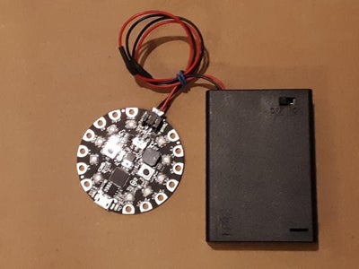

Step 2: Add a Battery Pack to the Circuit Playground Express
Although you can power the Circuit Playground Express with a micro USB cable, you will probably want to power it with batteries. The easiest way to accomplish this is to solder the leads from a 3 AA cell battery holder and a JST-PH 2 pin - Female cable which can plug into the power input on the Circuit Playground Express. It is recommended that you cover these connections with shrink tubing. The battery holder has a built-in switch, so the Circuit Playground Express can easily be switched ON and OFF.

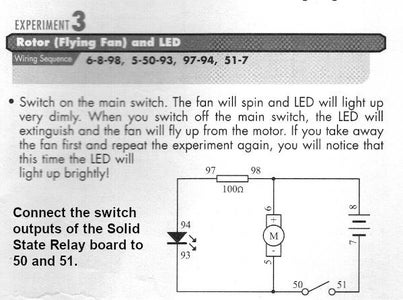

Step 7: Using RTPlayground2 With Tedco's Tronex 288+ Kit
Because it is really easy to replace the switch in any Tronex 288+ or Snap Circuits project with RTPlayground2 loaded on a Circuit Playground Express, you immediately can take over 288 plus projects in the Tronex set and make them far cooler! One thing that's nice about the Tronex set is that it has a number of projects using its built-in sound chip that can produce a number of animal sounds.
As a really simple example, wire up Experiment 3: Rotor (Flying Fan) and LED on the Tronex 288+ set according to the instruction booklet. Then, connect up the Circuit Playground Express to the Solid State Relay as described in Step 1 of this instructable, wiring the switch outputs of the Solid State Relay board to 50 and 51 of the Tronex 288+.
Select Pgm:0
The motor should start and stop turning on a periodic basis. The red LED will also be blinking on and off. Button B on the Circuit Playground Express can be clicked to adjust the rate at which this happens with settings of 3 secs, 5 secs, and 7 secs.
Select Pgm:1
The motor and LED will be activated with a loud sound (like clapping your hands) or by pressing a button on an IR remote control while it is pointing at the Circuit Playground Express. Button B can be used to set the length of time that the motor and LED will be activated.
Select Pgm:2
Pointing a flashlight at the light sensor on the Circuit Playground Express turns on the motor and the LED. Turning off the flashlight turns the circuit off.
Select Pgm:3
You will need a potentiometer for this experiment. Connect the Circuit Playground Express's Gnd to one end of a potentiometer, 3.3V to the other end of the potentiometer, and A1 to the middle connector on the potentiometer. If you have a Tedco Tronex 288+, you will be connecting to pins 16, 17, and 18 on the Tronex board. Turn the knob to see at what point the circuit turns ON and OFF. (You may also want to think about what type of circuit you would need to control the speed of the motor and brightness of the LED.)
Select Pgm:4
You will need two cards, one that is colored red and one that is colored green. When the Circuit Playground Express is showing a ring of red LED lights, you can put a red colored card on top of the Circuit Playground Express to turn the LEDs green and the circuit ON. You can likewise place a green card on top of the Circuit Playground Express while it is showing a ring of green LED lights to turn them red and the circuit OFF. In this way, you can use colored cards to control a circuit's operation.

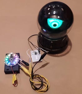

Step 8: Using RTPlayground2 for Halloween Fun
During the Halloween season, it's easy to find spooky animated devices that come to life whenever anyone approaches them. These devices most often also have a "Try Me" button that will trigger the device when you push the button. That's great for our purposes because all you have to do is connect up the Circuit Playground Express to the Solid State Relay as described in Step 1 of this instructable and wire the switch outputs of the Solid State Relay board to the "Try Me" switch on the device. Also check out the Remote Control Any Holiday Decoration instructable for a detailed example of this.
Select Pgm:1
The device will be triggered with a loud sound or by pressing a button on an IR remote control while it is pointing at the Circuit Playground Express.
Select Pgm:2
Pointing a flashlight at the light sensor on the Circuit Playground Express triggers the device.
Select Pgm:3
Combined with a Tronex set and your imagination, you can trigger the device when someone goes through a door or steps on a doormat, rings a doorbell, or a variety of other actions.
