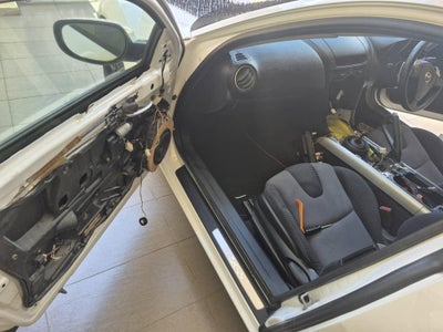

Was initially thought this was another plug and play android player. However, once i installed i discovered that my aircon stopped working. Having check out the forum it seems that you must include the old circuit board/headunit in order for the aircon to continue working. But the metra kit is too expensive and thus this is the alternative way around. Beware that this took me 2 whole days to do it, and thus it is not an easy project.

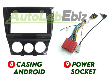

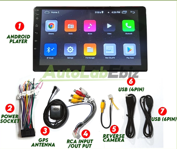

Android player with aftermarket casing. I use this player but I don't find it very good. Its very laggy.
https://shopee.com.my/-%F0%9F%8E%81FOC-Camera-Mazda-RX8-2008-2012-Casing-9-with-Android-player-QLED-Android-Auto-Carplay-i.115959142.19619901527?sp_atk=7fde16dc-476b-4320-8819-ff163a539193&xptdk=7fde16dc-476b-4320-8819-ff163a539193

  1. See first picture. Remove this connector because this plugs to the old connector. We will tap the signal/power from the old connector instead
  2. See second picture. Start chopping off the wirings from the new connector. MUST remember where the new wires connect to. At the end the red connector will not be used.
