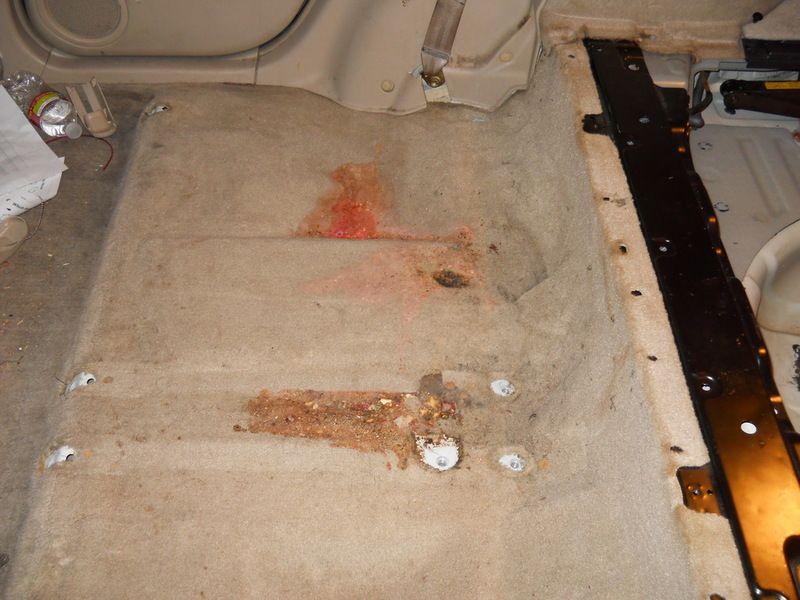

The fuel pump is located under the driver side back seat. You will probably find that it is easier to have both back seats out of the car in order to flip the carpet forward out of the way while you work. Also, it gives you an opportunity to clean while you have the tools out anyway.
Remove at least the driver side rear seat and flip the carpet forward out of the way.
