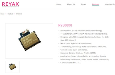

Step 3: Taking a Look at the Module and Its Datasheet
The features of the module:
• Bluetooth v4.2 & v5.0 with Bluetooth Low Energy
• TI CC2640R2F ARM® Cortex®-M3 industry-standard chip
• Can connect two Bluetooth devices at the same time
• Support Host-Client role.
• Designed with PCB integrated antenna, Suitable for SMD. Size: 115.94mm^2
• Metal cover against EMI interference
• Transmitting, Receiving, Wake-up by only 2 UART pins
• Control easily by AT commands
We see the following detail in the picture.

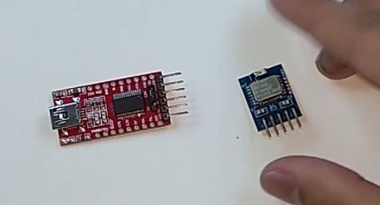

Step 5: Using the Module Standalone
We need to connect the Reyax module to an FTDI board, connections:
FTDI - RYB080l
Rx - Tx
Tx - Rx
Vcc - Vcc
Gnd - Gnd

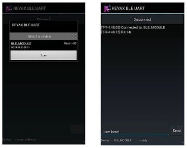

Install the app as mentioned in the GitHub repository on your phone to talk to the module.
Once all the connections are set you can talk between your computer and your phone/tablet with the app installed over Bluetooth, as we see in the image attached.

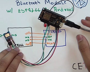

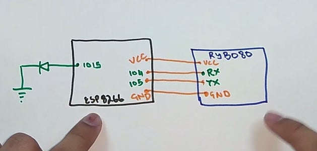

Step 6: Setting Up the ESP8266
Connect the ESP8266 to the Bluetooth module as per the above diagram.
Once connected use the code from GitHub and upload it on the ESP8266.
Github: https://github.com/akarsh98/Reyax-RYB080I-Bluetooth-module-with-ESP8266
Step 7: Testing It Out
Connect to the bluetooth module using your smartphone.
Once connected, send the word "LED" or "led" to toggle the LED.
Voila! thats how simple it is.
