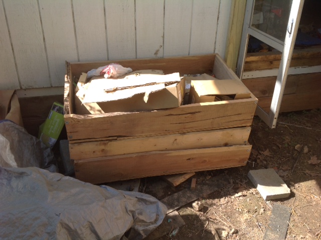

Introduction: Rabbit Hutch
This serves to give an example for building an elevated rabbit hutch for use over a vermi-composter or by itself. I designed and organized its construction for an Environmental Anthropology class, and it cost around $40 and half a day in labor.
I chose to use 2"x 2" beams for the basic structure and had to us a number of half lap joints to allow for the use of a single screw even when three beams were involved in the joint. The hutch is designed to house two rabbits with as little cleaning as possible, and needs a straw bedding to ensure their comfort. In the picture above, the hutch is being used for plants rather than rabbits as the intended occupants are still too cute to keep outside.

Step 2:
All of the joints are lap joints and will need to be cut to fit into each other. This is due to the fact that the 2"x 2"s allow for a lighter object but are too weak to take multiple screws in one location. Thus, the lap joints allow for only one screw while retaining the lightweight advantage of the 2"x 2"s. The front of the hutch is 4 inches higher than the back to allow water to drain off. We will proceed in the order the materials were listed.

Step 3: Assemble
To assemble, first remember that every screw must be pre-drilled, have a washer, and will go through three boards. I pre-cut these for my class to assemble, and thus they are featured in the pictures also.
Then join sections A, C and D, such that the screw passes first through A, then into the lap joint tongue on D, and then into the flat end of C, do this for both A sections and C sections. This will look somewhat like the first image plus the two C sections, and without the center vertical piece. That will come later. There are images provided of the final joints appearance.
Join the two B sections and the remaining D section in the same way to the other ends of the C sections. Image 2 in the top left hand corner of the plans indicates how both of these steps should be done. Remember that all of the sloping cuts at the tops of sections A and B ought to be sloping down in the same direction. The screw will pass first through sections B, then through section D before hitting the end of sections C.
Attach sections G and F to the tops of sections A and B. The screws should go through sections F, into sections G and then into beam A or B, depending on the joint. This will form a rectangular prism on stilts. The screw will pass through the tongues of F and G, and into the sloping ends of A and B leaving the whole roof tilted at a rate of 4" every 2', or two inches a foot.
Staple chicken wire onto the bottom of the cage, using two layers and keeping it as tight as possible. The double layering will help the rabbit's feet remain comfortable, yet let excrement pass through easily. Don't chicken wire the sides yet.
Now pass a screw through sections D, H and E in that order. Follow this by Passing a screw through A, I and E, such that this cross beam matches the other two C sections. You may need snips to cut the chicken wire away so that these go in easily. Make sure that you use the correct, lower E section, and that it goes in underneath the chicken wire. Now pass a screw through F, into the tongue of the upper E and then into the slanted end of the rear H. Do the same for the forward H. Remember to pre-drill and washer all joints. The structure is now complete and the remainder of the chicken wire can be applied to the sides with the staple gun. The reasoning behind this order is that it is easier to cut the chicken wire to fit the H and I beams after it has been attached rather than before. It would also be difficult to insert the wire with the upper section E in place.
Lastly, screw the hinges onto the roof board and into the rear Section F, so that the roof swings back away from the higher end. Staple shingles or appropriately waterproof cover into place (water proof paint would suffice). There is no need for a catch as the roof will be too heavy for the rabbits to lift.
