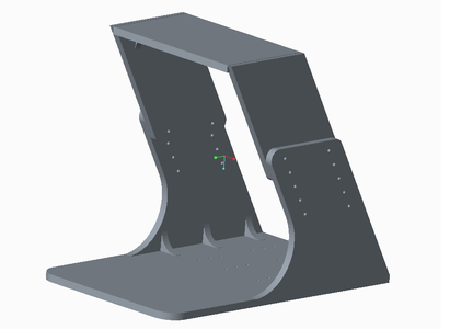

Step 2: Modeling the Wheel Stand
The design for the new wheel stand needed to incorporate the following elements:
- adjustable wheel height
- adjustable pedal-box placement
- suitable lateral support
- looks good!
- collapses for easier storage
- design for cutting on CNC router
I designed the stand in Pro/Engineer, and output .dxf files that I can open in Cut2D to generate the G-code I need to cut it on my homebuilt CNC router. The pedal-box hole layout on the baseplate is specific to the G920 and probably won't work with other brands, but the top plate should work with any wheel that has a clamping mechanism (I used the built-in clamps on mine even though it has threaded inserts for mounting bolts).
I made the holes on the uprights to fit 5/16" bolts since that is what I had on hand. I also had several 5/16"-18 threaded hand knobs that I was able to use on them, but I would consider them optional. The height adjustment method isn't so quick that the knobs are going to save you much over, say, wingnuts or even regular hex nuts.
The parts are cut from 3/4" plywood. I generally prefer to use Baltic birch plywood because its dense layers makes for an attractive edge, and its generally free of voids which is nice when you're cutting partial depth slots as I am here. It is slightly heavier than other less-dense plywood but I find the trade-off to be worth it.
The nominal 3/4" plywood I used turned out to be closer to 11/16" (about 0.70") so I made another set of drawings (slot widths set to 0.72") to give a tighter fit.
