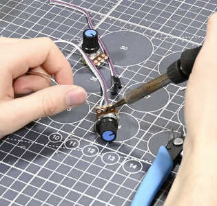

Step 3: Prep the Potentiometers and OLED Displays
To prep the potentiometers, I cut off the pin parts of their legs in order to make sure they wouldn't risk shorting against the metal case. Then, I soldered female jumper wires into the hole sections of each terminal on the potentiometers.
Then, you can solder some more female jumper wires to the two OLED displays. However, since we are using two displays, it's important that they both have different I2C addresses. There's usually a small SMD resistor on the back of the displays that can be used to change the I2C address of the screen, and so on one of my displays, I moved this resistor and one of the displays showed up as a different address than the standard one so that I could address them individually.

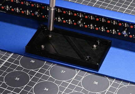

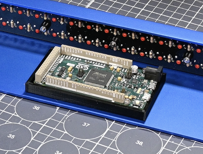

Step 6: Mount the Arduino
Next we'll mount the Arduino Due to the chassis. There is a 3D printed mounting tray for doing this, and this tray can be mounted to the chassis with the use of 4 M3x6 screws.
Then, the Arduino can be mounted to this tray with the use of four more M3x6 screws.

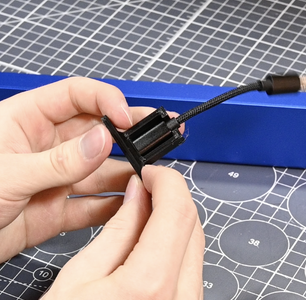

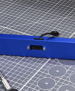

Step 7: Mount the Usb Port
Now we'll use the small male Micro-USB to female USB-C cable to put a USB-C port on the back of the enclosure. There's a small 3D printed piece that you can slip the Micro-USB end through, and then you can thread the rest of the cable through until the USB-C end gets held in place by the plastic piece. If you want, you can put some hot glue in here just to make sure that the USB-C end doesn't go anywhere when unplugging the cable, although the fit should be decently tight already.
Then, this whole assembly can be mounted to the case's back panel with the use of two M3x12 bolts and nuts.
Step 8: Wire Up the Main PCB to the Arduino
This part is probably the trickiest part of the whole process. Use the female-to-male jumper wires to make the connections from the main PCB to the Arduino. At this point you can also plug the OLED screens and potentiometers into the main PCB. I've provided the schematic and a pinout guide to help you make all of the right connections.
The switches just need to connect to digital pins, I connected SW1 to pin 22 and SW32 to 53 with all of the other switches in between. SDA and SCL for the displays connect to SDA and SCL on the Arduino, and Pot 1 connects to A0 with Pot 2 on A1. +3.3v and GND should be self-explanatory.
