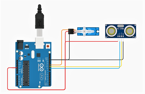

Step 3: CIRCUIT DIAGRAM
Follow the circuit for making a connection.
