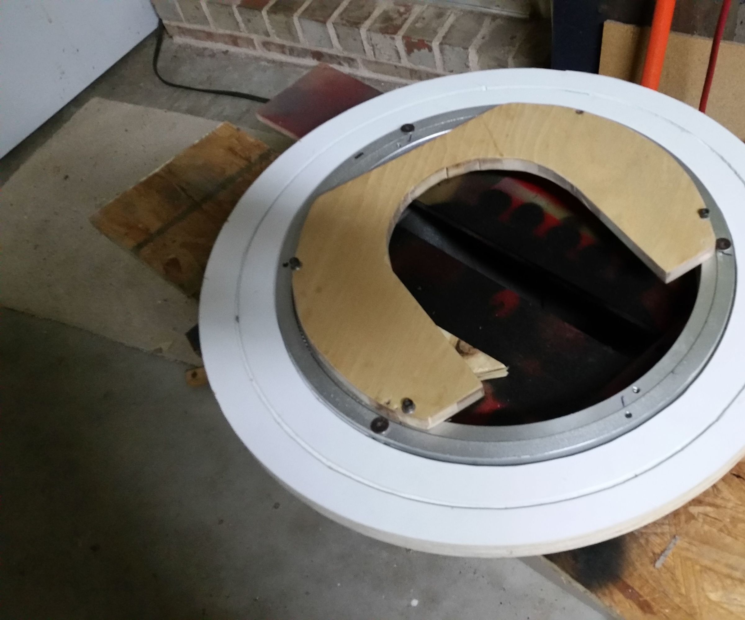

Step 1: Unhiding the Router Mount
To enable the mount for use.
Remove blade guard,
Remove blade (see it now , yeah, the ugly piece of angle steel)
Swing the motor around on X axis, till shaft faces you.
Hit the bevel release, and swing the motor down on Z.
Shazam! (as pictured now, unfinished) mount is visible and use position.

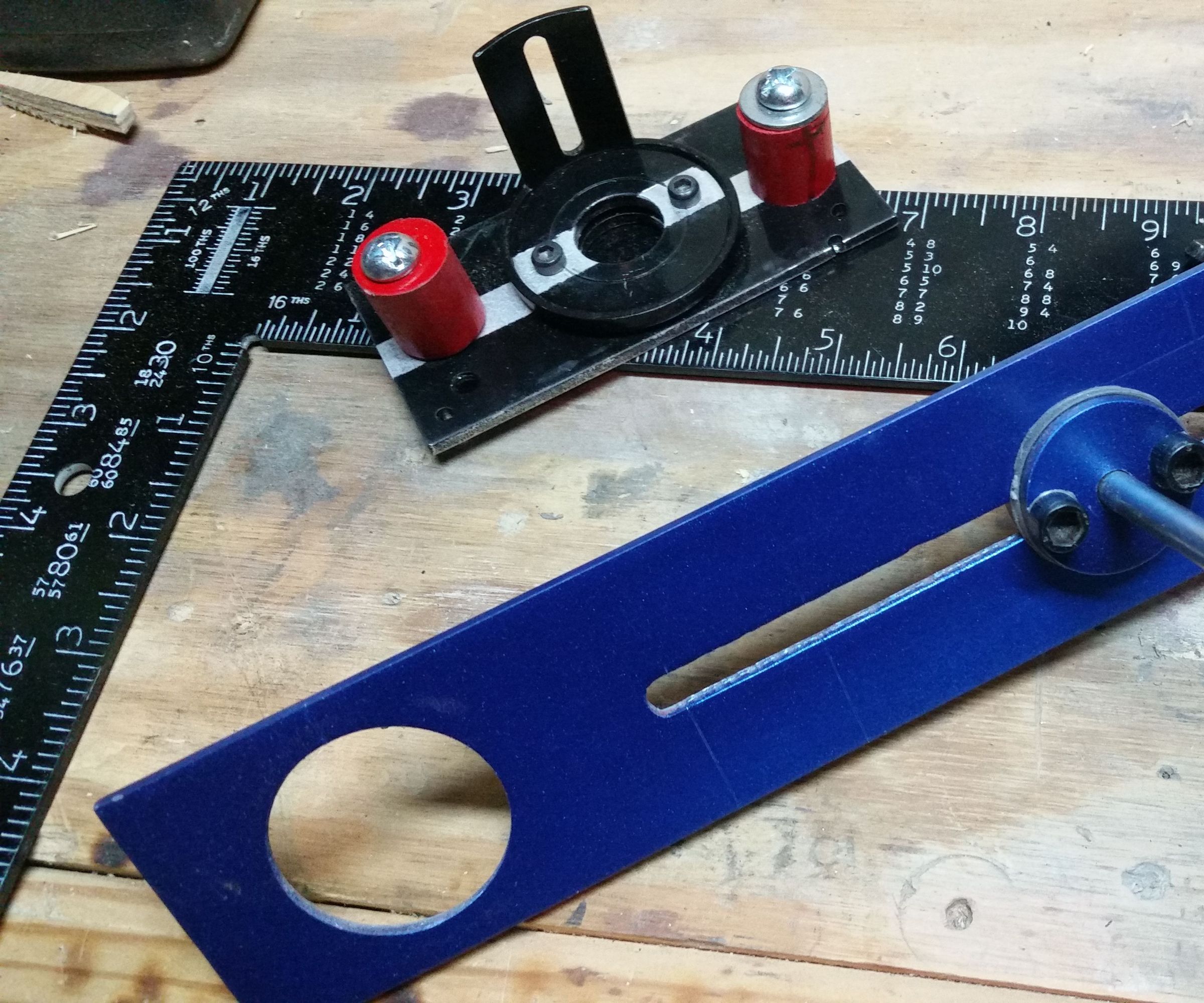

Step 2: Sizing Up Things
Step 3: Backing Mount to Saw
Step 4: Router Mount
