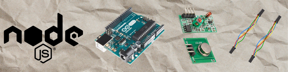

We will use an Arduino board, a few cables, and of course, a 433Mhz radio receiver and emitter boars. Bear in mind you can use other frequencies as well but that will depend on the device you want to clone.

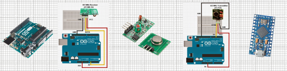

As you can see I use this way of connecting the boards. I have to mention, that I have seen other ways of connecting them but for me, this way works perfectly. The receptor is connected to 3.3v and to the analog A0. And the emitter to 5v and the digital pin 4.
