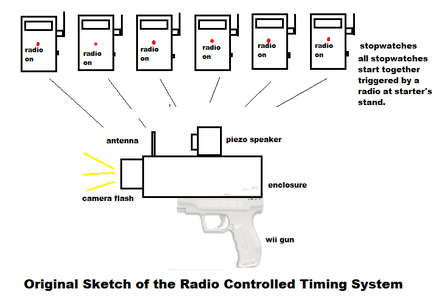

As a teacher and member of various sporting organisations, I have observed various different timing systems, from the traditional stand-alone stopwatches to more sophisticated (and very expensive) co-ordinated systems that simultaneously time, then record race data. The system is still under construction. I have commenced writing this Instructable early as I have already discovered some pitfalls and shortcuts!.

Starter GUN Transmitter
- nRF24L01 2.4GHz Radio/Wireless Transceivers.
- Arduino Uno
- Wii gun controller with momentary button attached
- 12 volt piezo speaker+ voltage booster
- camera flash +opto-coupler
- Five AAA rechargeable batteries
- enclosure + jumpers + protoboard , 10uF capacitor
- capacitor 47 uF capacitor .33 uF 3.3 volt regulator
Six Identical Receiver Stopwatches
- Arduino Uno
- momentary stop button
- reset button (can't be knocked mid-race!)
- 16 x 2 LCD module
- 5 permanent AAA rechargeable batteries.
- on/off barrel key switch (can't be switched off mid-race!)
- Red LED (RSSI indicator) 330 ohm resistor
- enclosure + jumpers + protoboard (see above) lanyardeye bolt

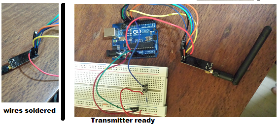

Step 2: Prepare Radios and Attach to Uno
NEED:
- breadboard with a momentary switch
- all equipment from step 1
- soldering equipment and lots of different coloured wires
- male headers (optional if not using jumpers)
- all equipment from step one.
- go to maniacbug and read all preliminary info on 2.4 ghz radios.
- On both radios, solder all coloured wires (or cut off jumpers with male end attached) onto radio module headers - try and use maniacbug colour coding above.
- HINT: Check for short circuits
- HINT: Attach 10uf capacitor to VCC and Gnd, close as possible to the radio- check polarity.
- Set up breadboard and attach momentary button to digital pin 7 and 10 k pullup resistor to gnd. Attach 5v to other side of momentary switch. Diagram.
- HINT: To ensure button works Try running the arduino 'button' sketch before adding radio module
- Attach radio headers onto UNO. Pin allocations are:
- Pin 9 orange
- Pin 10 yellow
- Pin 11 blue
- Pin 12 violet
- Pin 13 green
- Gnd black
- 3.3v red
