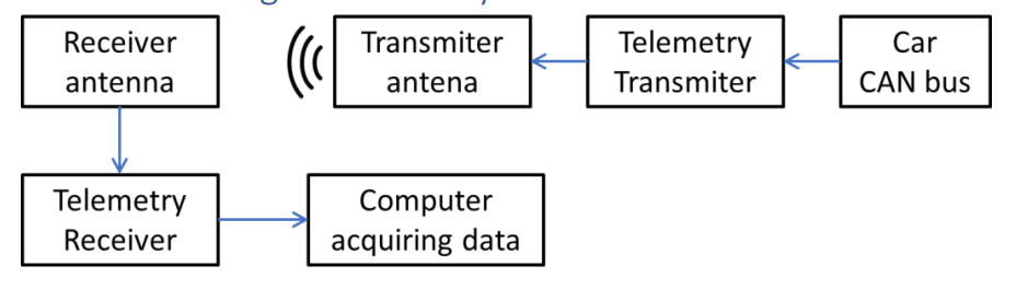

Step 1: Block Diagram of the System
Diagram of the whole receiver-transmitter system looks like this.

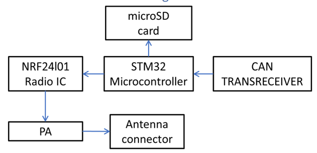

Step 2: Transmitter Block Diagram
Transmitter is based on STM32 microcontroller and NRF24L01 Radio IC. Transmitter is also able to log the incoming data to SD card.

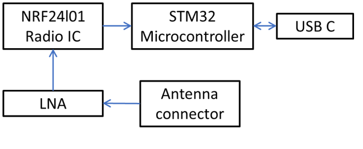

Step 3: Receiver Block Diagram
Transmitter is based on STM32 microcontroller and NRF24L01 Radio IC. It is offering PC connectivity by USB C connector.

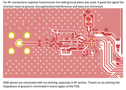

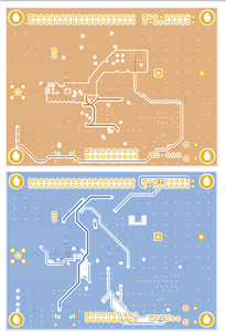

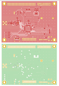

Step 5: PCB Project

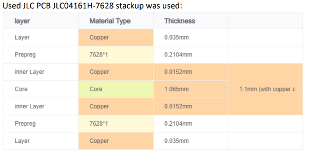

4 layer PCB was used, cause of lower distances between copper layers, and simultaneously not significantly higher cost. The ground plane was poured on every layer. The 3.3V power was routed on layer 2. JLC PCB JLC04161H-7628 stackup was used:
Step 6: Final Layout
Final layout was designed to fit on the top of already in-use motherboard: https://www.instructables.com/Multi-PCB-Motherboard/

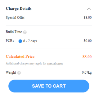

After making sure your PCB looks good – by clicking Gerber viewer, you can now place the order at a reasonable price. In case of this project, there is 8$ for 5, 4-layers PCB and it’s only 6-7 days build time(the time is extended due to the chosen color). To place the order, click on the “SAVE TO CART” button. Fast and cheap, right?
The quality is always really satisfying so we sincerely recommend JLCPCB.

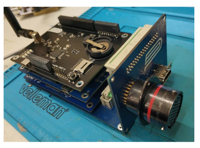

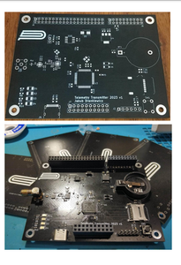

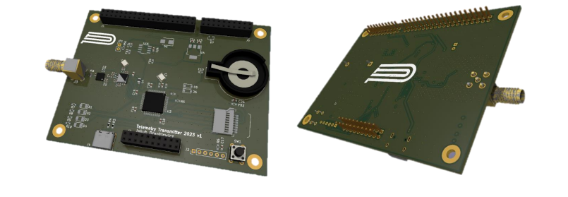

Step 8: Final Product
The PCB’s were manufactured by JLC PCB. Their services are fast and affordable. The 4 layers PCBs are impossible to do at home, especially with so small spacing between tracks, large amount of vias and the high precision required by the RF signals routing. We’ve chosen to solder the PCBs ourselfs, but JLC PCB also offers soldering services with huge selection of available components.
