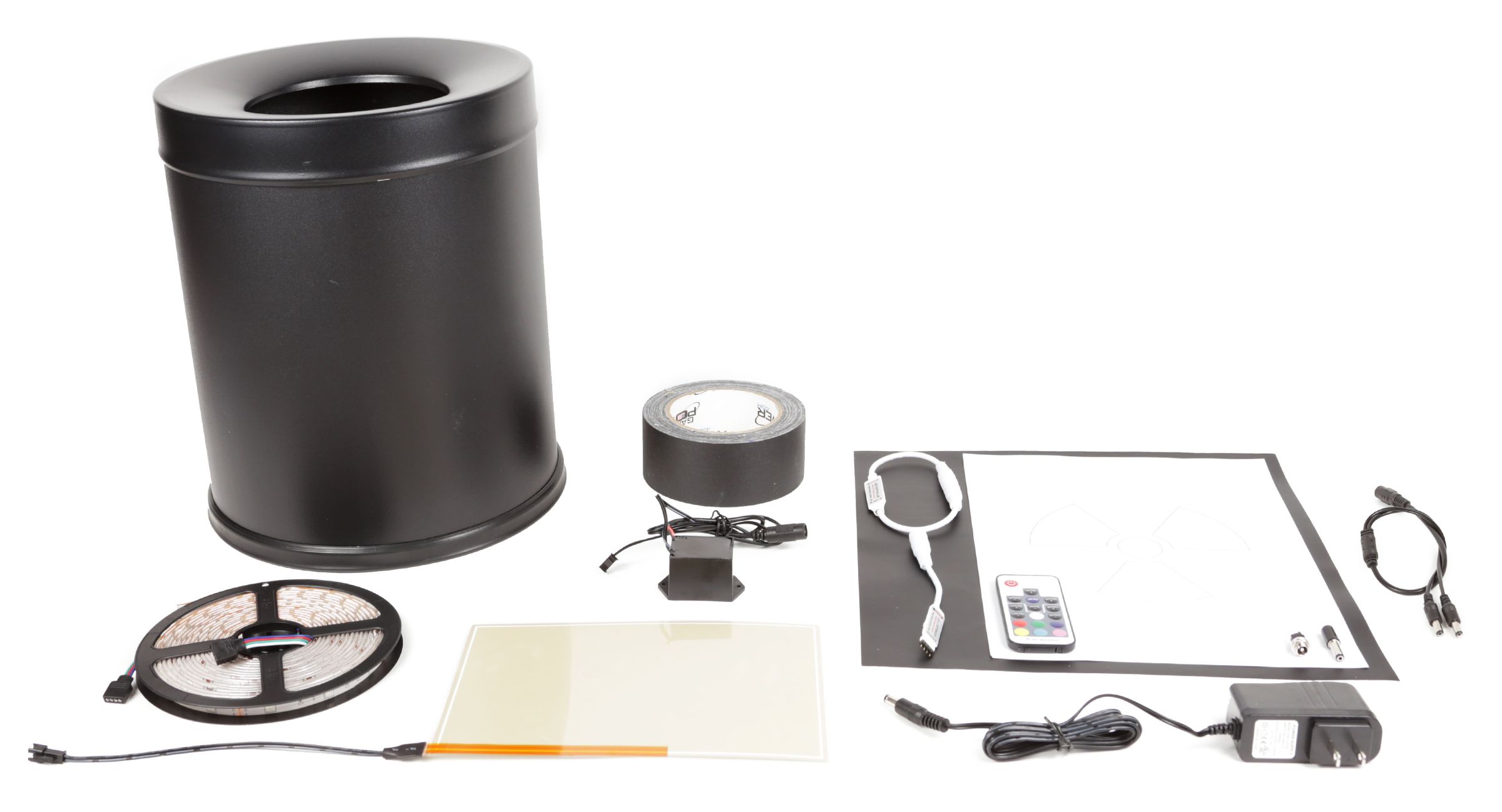

For this project you will need:
(x1) Adhesive-backed RGB multi-color LED strip
(x1) RF wireless color remote
(x1) RF wireless monochromatic remote
(x1) 20cm x 15cm EL panel
(x1) EL wire Inverter
(x1) 12V / 2A power supply
(x1) Power adapter splitter
(x1) Power jack
(x1) Power plug
(x1) 12" x 12" adhesive vinyl sheet
(x1) Black trash bin
(x1) Roll of black tape
