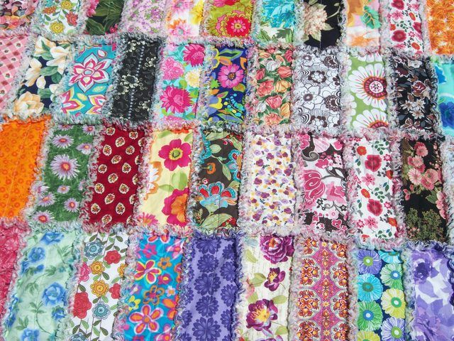

Introduction: Rag Quilting for the Beginner
For the Beginner. This is for the Beginner who wants to learn how to make Rag Quilts.
Step 1: Making a Rag Quilt
This is the Basics on how to start a Rag Quilt for a Beginner, once you start working on a quilt, it will be easier and faster working on them. I am making a Mini Nine Patch. I have basically made it Step by Step, there seems too be alot of steps but I wanted too make it easy for any beginners who want to learn how to make Rag Quilts.
There are other methods people use too make Rag Quilts. Once you start making them more often you will find your own shortcuts on how these are made. I thought this would be the easiest for a Beginner.
I myself do not wash and iron my Fabrics. Although some ladies do. Its your choice. I recommend starting out with scrap fabrics too practice before you go and buy fabrics too make your quilt. This way if you make a mistake you will not ruin your good fabrics. Such as cutting your square smaller then what you wanted. I have done that a few times. Rag Quilts are very Forgiving, if you do make a mistake when sewing it really won't be noticeable.
Just be Careful…you may get addicted. ;)

Step 23: Finished Clipping
Your quilt will look like this when you have done all the clipping. Then you sew your 1/2" around the edge of your quilt and then you clip that also.
Step 24: Brushing Your Clipping
There are various ways too Fluff up your clipping on your quilt. You can use a Butter knife by using a back and forth method on the clipping. Any stiff Bristle type brush. I use a Potato Peeler with a Brush to brush my clipping. Do the brushing before putting in the washer, then also before putting in the dryer. Always wash your quilts in Cold Water and Dry on a Low Heat Cycle. You can also Hang outside on a clotheline to dry.
Step 25: Finished Quilt
This is how your Finished quilt should look. I hope this Tutorial will Help you in starting to make rag quilts.
Good Luck and Happy Ragging!
