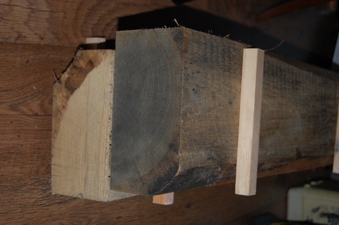

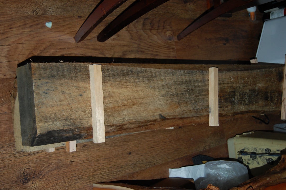

Step 2: Join and Sand Sleepers
I next needed to join the pieces to make the legs and top 400mm wide. I thought quite a bit about this as I am not too sure how well glue will perform when joining green timber together. In the end, rightly or wrongly, to join them together with biscuits and glue. I used a biscuit router bit to cut full length grooves in the top and bottom of the timbers used a combination of biscuits and thin slices of beech I cut to fit (making sure the grain of the wood was running perpendicular to the joint). The two timbers were quite difficult to line up and clamp together but once they were they were very difficult to pull apart and move with relation to each other (unclamped) so was quite happy with the method. I'm not too sure about the longevity of the joints but will be able to fix them if they ever do shift about.

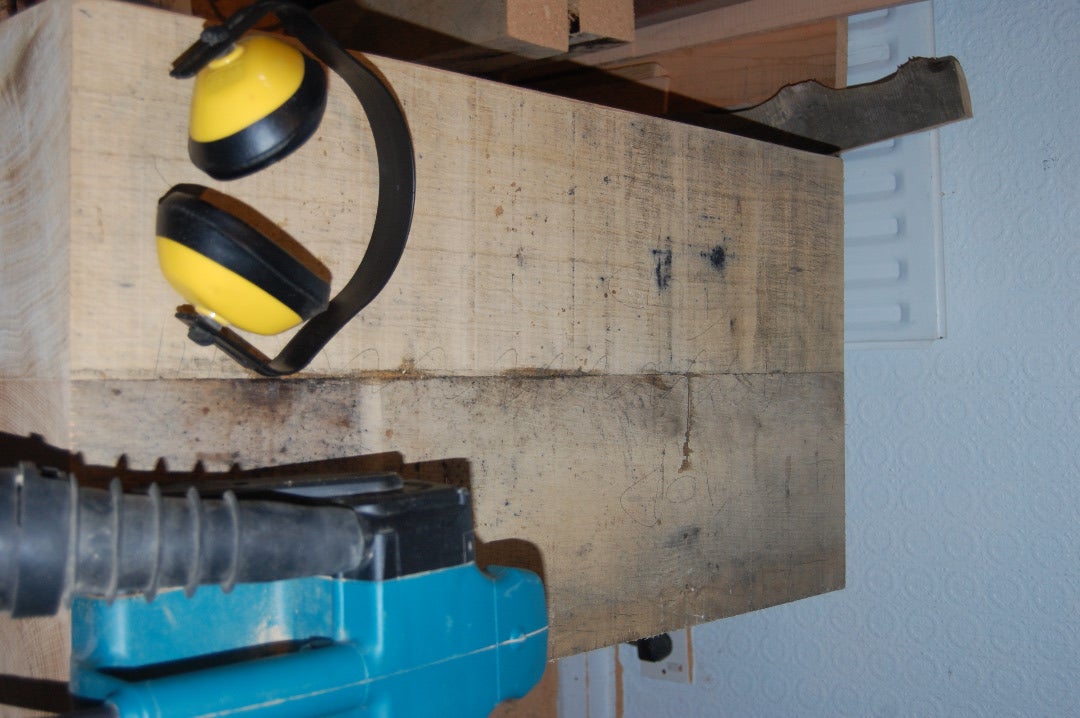

On the top part the two timbers weren't quite flush at the ends, but too far out to sand flush, so I thought I'd trim with the table saw. I started to place the timber on my sliding table extension but the weight was too much and I could see that the extension was bending so I abandoned that method. I changed to a circular saw with a piece of laminate flooring for a guide, turning the timbers over to complete the 100mm deep cut.
I then sanded all the parts with a belt sander with 40 grit paper. I then switched to a random orbital sander with 100, 180 and 240 grit paper.
