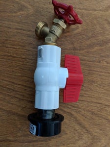

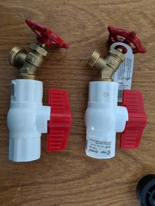

Step 1: Building the Valves
I chose to go with a 2 valve approach as I will be leaving one connected permanently to a hose, and wanted to have the option of filling up jugs, water guns, etc without having to disconnect the hose.
1. Screw the 3/4" MPT x MHT adapter into one end of the threaded valve.
2. Screw the 3/4" nipple into the other end of the threaded valve.
3. Screw the other end of the nipple into the 3/4" PVC Schedule 40 Bushing Spigot x FIPT
4. Insert the assembled parts into the 1 1/2" section of the PVC Tee.
5. Repeat steps 1-4 for second valve

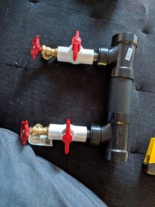

6. Cut a piece of PVC tube
7. Connect valves together with PVC tube

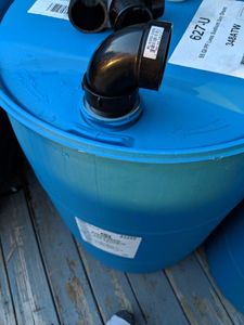

Step 2: Connecting Valves and Barrels Together
1. unscrew one of the bung holes in each barrel
2. screw in DWV MIP Adapter into the bung hole
3. Connect elbow to the DWV MIP Adapter
4. Connect assembled valve piece (from previous step) to the elbows to join the barrels together
Note: I connected this upside down to make it easier to see what it looks like when it is connected. Ideally, this will be done after placing the barrels in place.

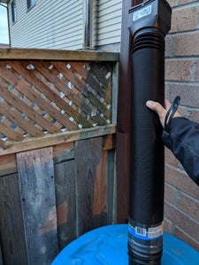

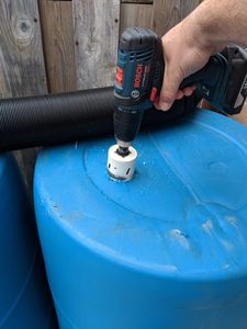

Step 5: Preparing for Downspout Connection
1. Determine where you will place the hole in the barrel
- I did this by simply doing a mock up of how I would like it and then made a note of where to drill
2. Using a drill, drill a hole into the barrel
3. I did not have the right size bit, so I drilled a couple holes and used a utility knife to shave the edges to make it fit
4. Using some force and a screwdriver, I connected the downspout extension into the hole that I just drilled

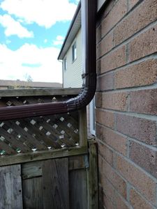

Step 6: Connect Downspout to Barrels
1. Determined where I would cut into the downspout
2. Using the hacksaw, cut out a section of the downspout
3. Connect the elbow to the current downspout
4. Using the screws to secure the connection
5. Attach 10ft downspout to elbow
6. Using the screws to secure the connection
7. Attached the plastic extension to the end of the 10ft section
8. Using the screws to secure the connection
Connection to barrel and downspout completed!
