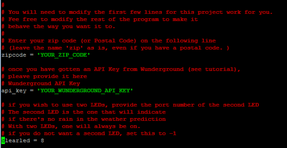

Step 6: Configure the Software
Now all you need to do it customize the module to your own geolocation.
Edit the file by opening it with nano
nano rain_notifier.py
Any line that starts with a # is simply a comment and is not part of the actual program. They’re explanations from us to you.
You only need to edit three lines
zipcode = 'YOUR_ZIP_CODE'
api_key = 'YOUR_WUNDERGROUND_API_KEY'
clearled = 8
Change YOUR_ZIP_CODE to your actual zip (or postal code), make sure to keep the quotation marks.
Change YOUR_WUNDEGROUND_API_KEY with what Wundeground assigned you and keep the quotation marks there too.
If your clear-sky indicator is on port 8, then leave that third line alone. If you choose to have only one LED, then set this one to -1.
Then hit Ctrl-X to exit.
Click the Y key to confirm that you want to save the changes.
And then press Enter to confirm the filename.
Your changes are done, you now have a working system!

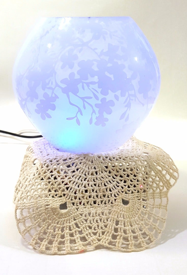

  • Lamp
Put the two LEDs at the bottom of a small frosted lampshade. We got one from Ikea, called Knubbig. We used clear tape to keep the LEDs in place at the bottom. That way, the lamp is still functional as a regular lamp too. Put the lampshade near your umbrella stand, or near your front door. Run a final test, then hide the Raspberry Pi behind the umbrella stand.
