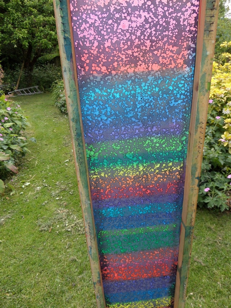

Step 6: Applying the Darker Background Colour
Here I'm getting the darker background colour mixed, I wanted a dark blue/purple colour which would show up the bright coloured spots.I added a bit of water to make it go a bit further and applied with a foam brush. The coloured waxed areas are protected from the dark blue dye,it's just like those magic colouring books I used as a child!
Luckily I managed to mix up enough dark dye for this project, always something to consider as remixing mid flow can be tricky.

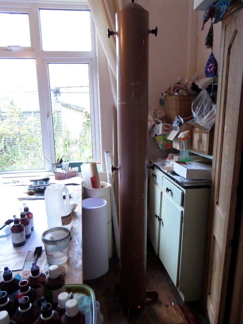

Step 8: Steaming the Silk
First take the silk off the frame and using lining paper roll onto a cardboard tube. Place water in the first compartment of the vertical steamer, attach the second compartment and place tube inside. Place third section ontop and set for 2hours.
