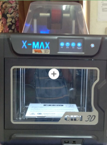

3D Printer

Step 2: 3D Print Web
3D Print web using different filament colors.
