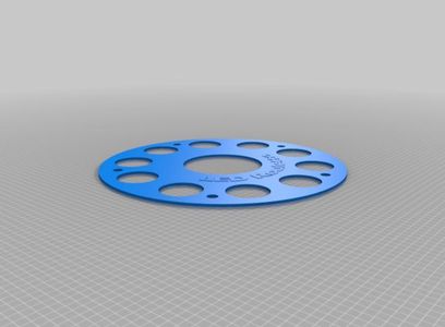

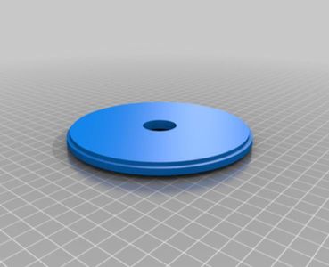

-0.5mtr x WS2812 LEDstrip
Tools: -lasercutter
-3D printer
-Soldering Iron
Step 2: Step 2: the Building.
Op thingiverse staan alle file om de lasersnijder en 3d printer aan te zetten.
https://www.thingiverse.com/thing:3830895
It's all pretty easy to make:
1 - let the laser cutter do its job with the plexiglass and plywood
2 - Putting 3D printer to work over night. Saves time!!!
3 - Programming the arduino. (Program is in the next step.)
4 - Soldering the wiring according to scheme.
Cut the outside of the Usb Cable. Then cut the red wire. Solder the cutted ends to the switch.
5 - put everything together
6 - Testing everyting
