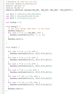

Edit : I just came to realize that I put the colors in the wrong order... So the illustration show a "upside down" rainbow. I did correct the code and the image of the code, but I didn't have opportunity to made new photos. Please Newton forgive me (you who use to say ther was seven color in the rainbow, superstitious fellow)

Step 2: Upload the Code
Plug the arduino to your computer with the USB cable and upload the code shown above and provided below in the arduino using the arduino IDE (See https://www.arduino.cc/ to learn how to do that if you don't already know).
If everything is OK you should already see the led turn on and show the color of the rainbow as on picture
