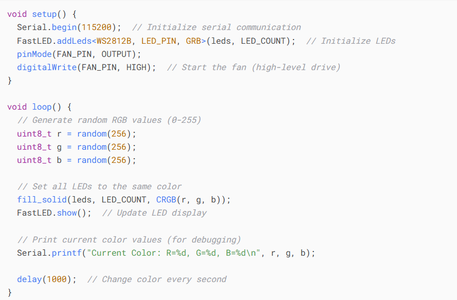

Step 2: Hardware Programming
This section implements the basic functionality of controlling a fan and RGB LED strip using the ESP32. Upon power-up, the fan will start immediately (running at full speed), while the RGB LED strip automatically cycles through random colors every second (R/G/B values are randomised between 0-255).

3、Uploading the Code
  1. Install the FastLED library (for controlling the RGB LED strip) in the Arduino IDE.
  2. Upload the following code to the ESP32.
Code Explanation
  1. random(256): Generates a random integer between 0-255 for RGB values.
  2. fill_solid(): Sets all LEDs to the same color.
  3. FastLED.show(): Updates the LED display.

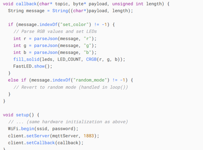

Step 3: APP Development & IoT Communication
I developed an Android/iOS app based on the MQTT protocol to remotely control the RGB LED strip colours and fan switch.
Steps
  1. Communication Protocol Design
  2. MQTT Topic: device/[MAC address]/control (for sending control commands).
  3. APP Development (Example: MIT App Inventor)
  4. UI Design:
  5. Color Picker
  6. Toggle button (switch between random/fixed mode)
  7. Device connection status display
  8. Logic Implementation:
  9. Scan and bind the device's MAC address.
  10. Send control commands via an MQTT broker (e.g., HiveMQ).
APP Features
Custom Color Selection: Choose colors from a palette and sync them to the hardware in real time.
Mode Switching: Toggle between fixed colors and random cycling.
Device Management: Save multiple device MAC addresses for quick switching.
Step 4: Final Verification
  1. Hardware Test
  2. Upon power-up, the fan should start immediately, and the RGB LED strip should begin cycling through random colors.
  3. The serial monitor should print new RGB values every second.
  4. APP Test
  5. After sending {"cmd":"set_color","r":255,"g":0,"b":0}, the LED strip should turn red.
  6. After sending {"cmd":"random_mode"}, it should revert to random colors.
