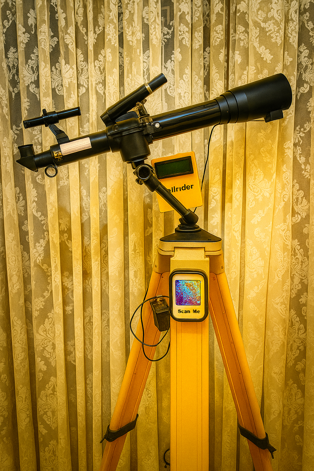

Step 8: Finished Device – Gallery
Here are some shots of the completed Rainbow QRFlasher in action.
The colorful LEDs light up the QR code beautifully, making it eye-catching and fun.
Whether you're showing it off at an event or placing it on your desk, it's sure to grab attention!
