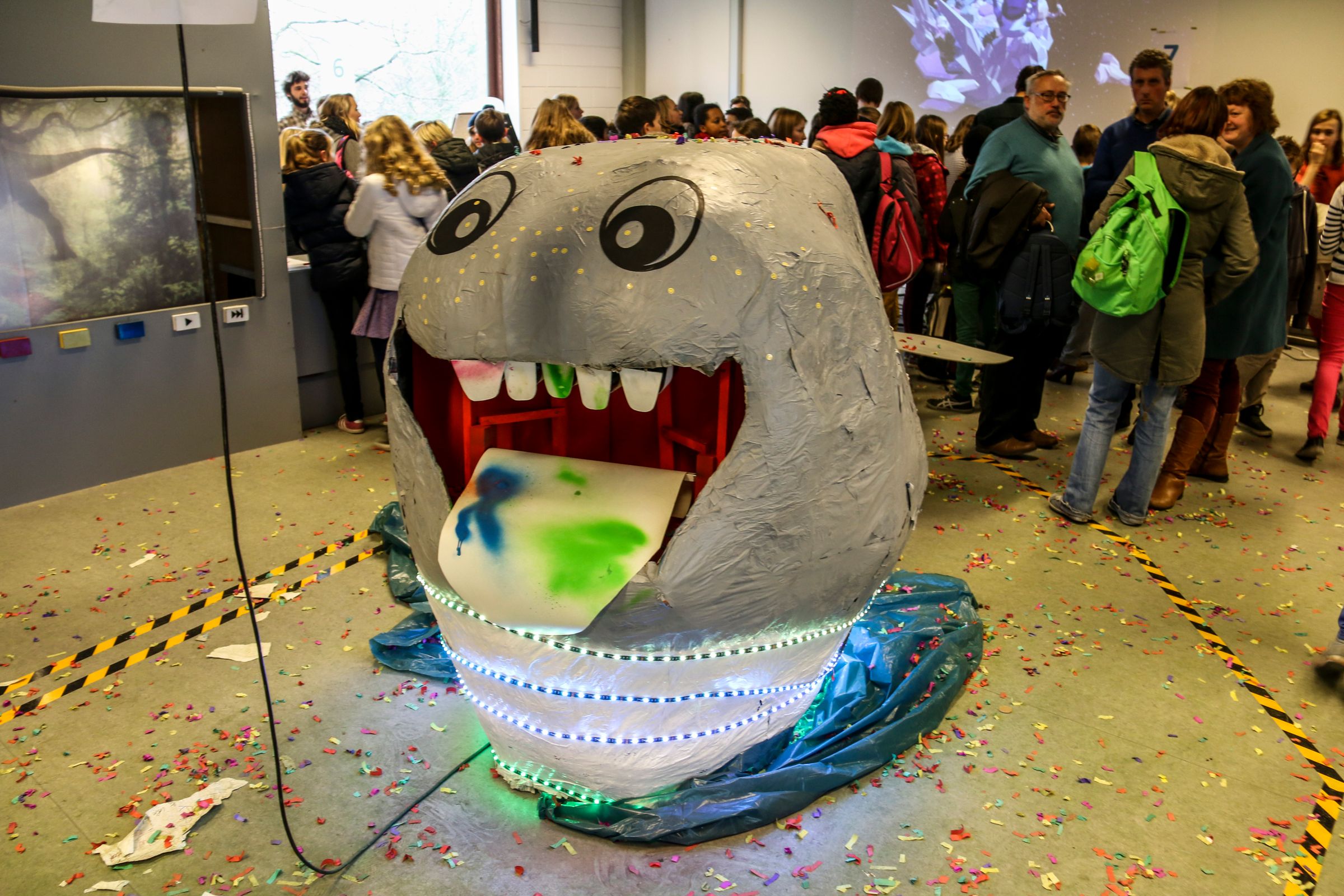

We are students at the West-Flanders High School (HOWEST). We study industrial product design and for our project "My Machine" we worked together with a primary school and a technical secondary school. The primary school had to draw their dream machine(see drawings above) we made the concept realizable and made the first prototype. The secondary school will make the prototype in the final materials using our technical drawing.
The rainbowspitter is designed to make children happy. They can colour it's tongue and move the tail up and down which causes to light up more or less lights. When all the lights are lit, confetti comes out of the spout hole of the whale as a climax for the kids (it really does make the kids happy).

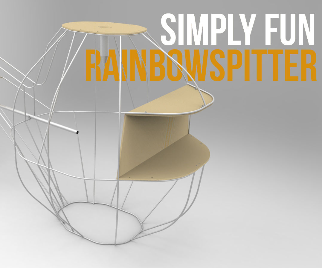

First you will have to make three octagon's out of wooden beams as displayed here above. Two octagon's are smaller and will be used for the bottom and the highest layer. The biggest octagon will come in the middle. Next you will connect the edges of the octagon's and make sure that the structure is stable in all directions. Make sure you leave space for the mouth of the whale.
When all three octagon's are connected you need to make the frame for the tail of the whale. Look above in the technical drawing for how you have to place the wood.
The frame has to be stable when kids push the tail up and down. To prevent the frame from moving you can make the frame heavier at the bottom for counter weight.

We are going to use the frame to stretch the chicken wire over it. You can nail the chicken wire on the frame. Finally put newspaper or other fine paper on the chicken wire and fill the form by gluing the newspapers together with wallpaper paste.
Step 5: Paper Roll and Spray Cans
Just take a simple stick or cylinder and attach it to the frame and put a roll of paper on it. Make sure you can change the roll when there is no more paper left.
At the top of the mouth attach with nails a thick elastic band as displayed in the picture. Make sure that spray cans fit in the elastic and that they can't fall out. At the bottom of the spray cans you can attach wooden plates in the shape of a tooth so that it looks like the whale has teeth when the spray cans are fixed in the elastic band.
Step 6: Painting and Lights
Now we will paint the whale: white at the bottom, grey on the upper part and red in the mouth. Then glue two eyes on the whale, cut out of black paper. Lastly take four LED strips and stick them evenly spread on the white surface.
