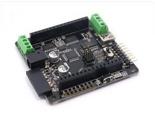

1. Rainbowduino LED Driver Platform

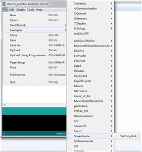

Open the required sketch via this path: File --> Examples --> SnakeGame --> Withjoystick.

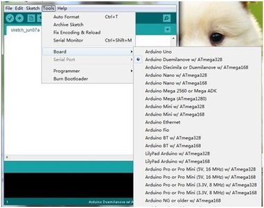

Rainbowduino features an Atmega328 chip onboard, so choose Atmega328 in the pull-down menu of Tools --> Board and its corresponding serial port. Now upload the program to Rainbowduino.

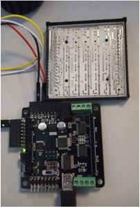

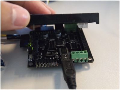

Mount the 8x8 LED matrix onto Rainbowduino.
Their footprints are compatible, so it's effortless to connect them.

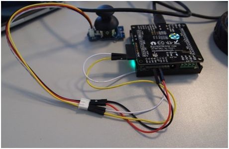

Then connect the joystick to the board.
The joystick we use is a Grove element and have four pins.
Put the joystick ahead of you like pic 2.
From left to right, these pins should go to A0, A1, VCC and GND on Rainbowduino.
