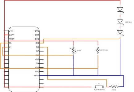

Step 2: Connect Parts to Circuit
I connected the parts of the circuit according to the above schematic. I used analog input pin 0 for the potentiometer, analog input pin 1 for the slider, digital pin 9 for the LED strip, and digital pin 8 for the button.
