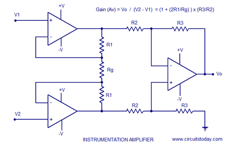

Step 2: Building an Amplifier
For this build, an instrumentation amplifier was used. The circuit was built using 6 22k ohm resistors, and a 200 ohm potentiometer. The above image shows the wiring of the circuit, as well as the positioning of the potentiometer. The red and blue wires are for the amplifier excitation positive and negative inputs. The green and yellow wires are the inputs from the pressure sensor. Finally, the white wire and the black give the output voltage from the amplifier.
Next, 6 22k ohm resistors need to be added. You can follow the picture of the complete circuit, or make it from the circuit diagram.
The potentiometer is the only restive component that adjusts the amplification of the circuit. Its value can be adjusted with a screwdriver. To get the correct collaboration, simulate a test using the maximum output voltage of the rainfall measurung apparatus. Add +15V and -15V to the amplifier, and finally, use a voltmeter to measure the output the amplifier is giving. Adjust the potentiometer until the voltage out of the amplifier is 5V.
Now that we have our amplifier built, just the code is left to be done!
