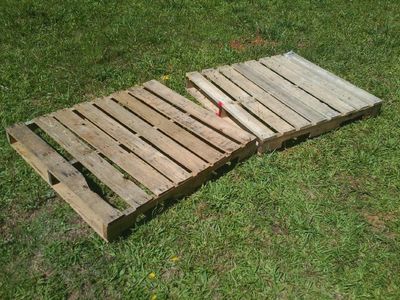

Step 1: Procure Pallets
I'm fairly new at this. I'm maybe a few years in at this point on procuring and building with pallets, but I've learned that there are businesses out there which receive products on pallets, the disposal of which is a nuisance to them. I'm lucky in that I work with one of them, so I can get satisfactory pallets from time to time. But I've found that if you keep an eye out, you can find businesses that don't want their pallets, by simply driving around back and looking to see if they have them sitting out in their loading area or dump area. If you see them, simply ask. Grocery stores are a great resource, if they will give you some of theirs, as they should be food safe. But don't trespass or steal! Some people and businesses value their pallets as much or more than us makers do, and reuse them for their business or sell them. There are an unlimited number of sizes of pallets, but I typically get only the 36"X40" size, as they are about the largest that will fit in the back of our Subaru with the seat folded down (we can fit about 4 at a time in there), are great for many home projects, and they are the most readily available size, at least for me. I don't want to get too attached to a size I can't regularly find. For this project, I am using two 36"X40" pallets. Also for this project, it is best to get pallets with the top slats as close together as possible and with an even number of slats.

On the bottom of the pallet, remove the middle slat with a prybar. If your pallets have an odd number of top slats, you will need to remove the middle top slat with a prybar, as well. If your pallet has an even number of top slats, your work will be much easier. Be patient and take your time to loosen all of the nails gently. It can be hard to remove the nails and the heads may pop off and/or pull through the slats, but to prevent damage to your saw in the next step, you will need to remove as many as possible if not all of the nails, and not simply beat them over with a hammer. First, pry gently under each side of the slat at each runner, working from one side of the pallet to the other, and starting again where you began, to loosen each connection more. You want the slat to do the work of pulling the nails out, if possible, but if you jerk too forcefully on the slat, you may just have the nail pull through it. I find that a small double-end prybar works much better than a hammer. I use needlenose pliers for the difficult headless nails that get left behind. You can bend the shaft in half and then use it as a handle with the pliers to twist the nail back and forth, while pulling.
Knock the nails and pry them out of the middle slats, and set the slats aside for later use. Though it would be easier work to have an even number of slats, the end result will look better if you have an odd number of top slats, as you will see.
Step 4: Cut Pallets in Half
Measure to the half-way point of the pallets and mark lines across each runner, in between the middle two slats on top of the pallet. Mark the bottom of all of the runners in the middle. Use your saw to cut the pallets in half. Be very careful while sawing, as you may run into nail fragments. Wear safety glasses, and don't use a nice blade for the job, unless you know for sure you won't run into any nails. If the dividing line is right on top of a nail, simply saw to one side of the nail, or other. There's no need to be extremely accurate with this, as it is just going on the relatively soft ground anyway. My circular saw is not big enough, depending on the slat thickness to get all the way through to the middle from the top side, as you can see in one of the pictures. If this is true in your case, you can finish it off with a hand saw, or just give the pallet a good swift kick to break the remaining wood connecting the two halves.
