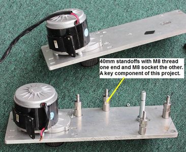

Step 3: 40mm Stand-offs Used to Bolt Two Plates Together.
The two plates have to be bolted together later on in a slightly unusual orientation. They also have to be spaced about 40mm apart. Easiest way to do this neatly and accurately was to use 4 stand-offs which were 40mm long.
These had an 8mm thread one end sticking out and an 8mm female thread the other end to take an 8mm (M8) bolt.

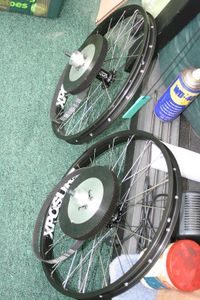

Step 8: Big Sprockets Bolted On.
Here my large (and very heavy as it turned out) toothed belt sprockets are bolted to the hubs with a ring of 6 bolts. I would do the same thing but with a regular bike chain sprocket and stick to chain drive.
Step 9: View of Plates Bolted Together and Wheels Assembled.
Two views of whole drive train assembled.

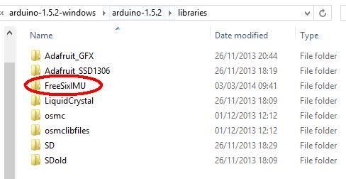

Step 26: CODE: Setting Up the FreeSix IMU Library on Your Computer
Download the folder "FreeSixIMU" from this website and put whole folder into your Arduino libraries folder so then the libraries listed above can be accessed by the Arduino.
Instructions on how to download this folder and put it into your Arduino libraries folder can be found here on this website (scroll down the page about half way):
http://bildr.org/2012/03/stable-orientation-digita...
This Arduino library was written by Fabio Varesano who sadly died not long ago. It reads the digital data from the IMU and processes the gyro and accelerometer information using a filter called a "Kalman filter" to work out what angle your machine is tilting at relative to the (always vertical downwards) pull of gravity.
My bit of the Arduino code (attached later) uses something called a PID controller which processes the IMU balance sensor information 100 times per second to adjust the speed of each motor many times per second to stop the machine falling over.
Step 27: FreeSix IMU Library Installed
Here is the FreeSix IMU library installed.
Jan 2015: I have attached a .pdf file showing some extra information on how the FreeSix library should be set up on your PC.

Step 30: Big Alloy Spacer.
A big high tensile smooth bolt goes through the wheel bearings from the outside and bolts the wheel to the alloy plate each side. There needs to be a spacer between inner wheel bearing and the alloy plate, to leave room for the tire to turn without rubbing the alloy plate, and also to leave room for the sprocket and chain (belt drive shown here) to function.
An alloy spacer of just the correct width so the chains/belt drives line up with the motors was made for each side on a hobby lathe. It needs to be narrow where it buts up to the inner bearing and nice and wide where it buts up to the alloy plate - this wide part spreads the loads and stops the axle bolt tilting upwards when your weight is placed on top of the machine.
Step 31: Big Alloy Spacer Fitted
Here the spacer is pushed into place and we are ready to bolt the whole lot to the side of one of the alloy plates. You can kind of see why it is the shape it is.

Step 39: The CODE for Your Arduino Mega
Here is the code attached as a text file, not as an Arduino sketch as Instructables has trouble with sketches.
There are two versions, a basic one and a more advanced one.
Get the "Basic" version working first, then go on to the next one which has extra features in it such as direction stabiliser, handbrake function, overspeed "leanback" to stop you reaching 100% power then falling off the front (see below for explanation of all of these).
Open the text file, copy and paste it into a blank new Arduino sketch page, compile it (set for a Mega board) then save the sketch on your computer.
Don't forget to download the FreeSix IMU library before trying to get this to run on your Arduino Mega.
