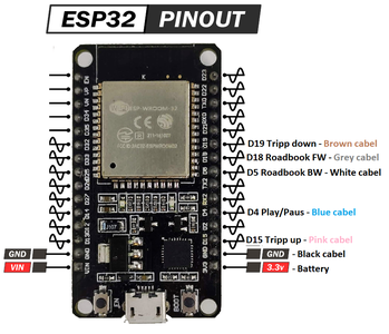

Connect the ESP32 to the computer and follow the IDE guide.
Then install the following packets to the library in the Arduino app.
BleKeyboard.h https://github.com/T-vK/ESP32-BLE-Keyboard
Bounce2.h https://github.com/thomasfredericks/Bounce2
Follow the guide to install the code to the ESP32.
Drill out the holes in the cover with a 4mm drill.
Dry fit the ESP32 in the case with the USB cable. the case if for a xxxmm micro USB with a 3mm diameter cable.
If the cable is bigger drill out the hole to fit, you might need to remove some rubber from the micro USB to make it fit.
Mount the sensor cable in the hole and cut the cables to length.
Soder the after the ESP32 pinout picture.
Connect the micro USB and screw the case together, if you want the case watertight use superglue and use spring clamps to make a tight seal.
Bounce2.h https://github.com/T-vK/ESP32-BLE-Keyboard
Here you can find the code. https://github.com/T-vK/ESP32-BLE-Keyboard
A new code will come!
If you use a dubbel AA battery holder solder a cable from one of the battery spaces + to -
Test and dryfit all the components in the 3D printed case.
Solder the battery holder+ to the On - Off toggle and then to the ESP32 3.3V pin.
Then the - from the holder to GND on the ESP32.
Soder the signal cable after the ESP32 pinout picture.
