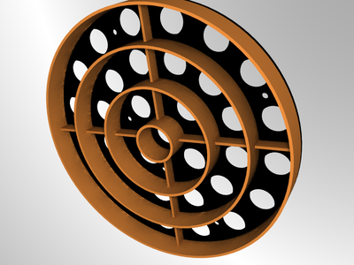

Step 1: Mechanical CAD Design
For my first parametric CAD design, I've tried to keep things simple as much as possible. I have separated the base and rings so that they can be painted differently. The parts can be 3D printed or machined.
I used black PLA and painted in bronze the Ring.stl part. I've also painted with a dark metallic grey the Base.stl. Ring.stl and Base.stl are glued together.

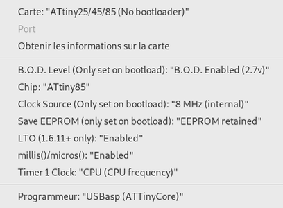

Step 5: Code
Since I've got severals ATtiny85 lying around I've used one for the controller mounted on a perfboard. I use ATTinyCore to compile the program (tutorials are easy to find, I use this core even for my Digispark boards instead of the official core). I've attached the board configuration in the tool menu of the Arduino IDE.
Digispark boards can be used without any modifications. Arduino Nano as well but you will have to change the PINs. The code automatically select the most optimized WS2812B lib (tinyNeoPixel_Static for ATTinyCore and Adafruit_NeoPixel for others)
The Pinning for ATtiny85 is :
