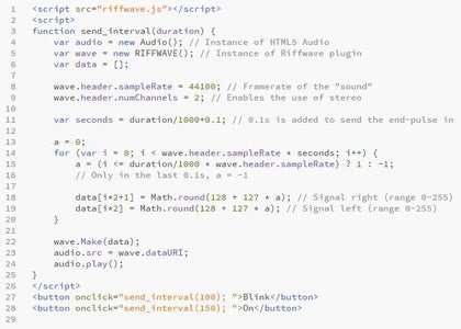

Step 3: Creating the Website
For the website, a very rudimentary code was written in JavaScript (JS) and some basic HTML. The result of which can be seen in the figure above. It uses the riffwave plugin by Darrel Banks, a simple plugin that allows you to code a sound file using JS.
A function, called "send_interval", creates and plays a sound and can be triggered by any JS event. In this example, two buttons were placed in HTML, each with the onclick event linked to the "send_interval" function with the interval given in the function (last two rows of code).
The function creates a sound file that doesn't contain a sound, but one block of a high (voltage) value for the indicated interval time. The duration of the resulting high voltage can then be measured and interpreted by the Arduino. It is better to use duration rather than voltage levels, since the voltage levels can vary depending on the resistances involved, whilst the duration always remains accurate.
The Browser to use: Firefox for Android
The sound file can then be played using the HTML5 audio feature. The only drawback to this is that is needs to be possible to automatically play sounds, which is not allowed by most mobile browsers.
In fact, the only well known mobile browser that completely allows the audio/video autoplay feature, is Firefox for Android. This browser also allows the website to make vibrations, use the gyroscope and accelerometer, and the website can be made completely full screen using a plugin, making this the ideal browser for interface testing.

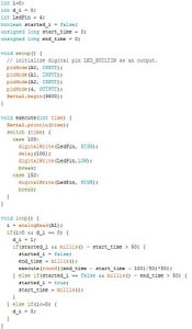

Step 4: Programming Arduino
The Arduino code, as is it in accordance with the website code discussed before, can be seen in the figure above.
Each of the three AUX wires are connected to the Arduino in a pull-down resistor setting, so that each of the individual voltages on the wires could be measured and visualized (Serial plotter). In this example, only the signal of the left wire was eventually measured and analysed, although it could be elaborated into measuring both left and right. The void loop was repeated continuously, with the value of i ranging from -2 to 0 when there is no activity, and ranging from 0 to 10 for up to 30 milliseconds at the beginning and end of a signal, which may vary depending on the pull-down resistors that have been used.
After the first part of a signal is being detected, signals will be ignored for the next 50 milliseconds, since the same signal seems to show inconsistencies here.
The signals come in pairs of two. When a first signal is detected, a timer starts. The Arduino then waits for the next signal to be measured, indicating the end of the interval. At this moment the timer is stopped and the elapsed time is used to determine the intended commando in the void execute. Interval are rounded on 50ms, since measured intervals deviated up to 20 milliseconds from the intended. This may be as a result of the 50ms that are ignored.
Step 5: Testing & Validating
When testing the setup, some problems were found in the consistency of the measured signal. This caused the program to detect multiple, very short intervals instead of detecting a single longer one. This was eventually solved by implementing the 50ms of ignoring the signal.
Other than that the system seems to work just fine. We are happy with the results and will possibly use this for prototyping purposes in a later stage of our current project.
