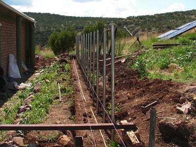

Step 1: Foundation
For a foundation, dig a trench and fill with gravel or rubble. Its width needs to be wider by a few inches on either side than your wall will be. The fact that you do not need a concrete foundation is one of the reasons that makes this method so cheap.
Step 2: Posts
Place posts every two or three feet on either side of your wall. You want the posts of one side of the wall to be directly opposite the posts on the other side of the wall. Make sure the posts are not leaning outwards. They can however lean in towards each other a little.
We have used metal pipes as posts as well as Juniper limbs. The advantage with the metal is that you can hammer them into the ground quickly. Tree limbs are much cheaper (in our case free), but you have to dig a hole for them. With short retaining walls that are only a couple of feet tall, you can use rebar - cheap and easy to pound into the ground.
Step 3: Bond Beam
Tie a C-purlin or suitable bondbeam material to the outside line of posts [the first time we did this, we put the bond beam on the inside of the posts, and learned that the outside would have been better]. Tie it at each post. You can also use a self-tapping metal screw at each post to hold everything in place. It needs to be just above the top of the posts. Make sure that it is level.
