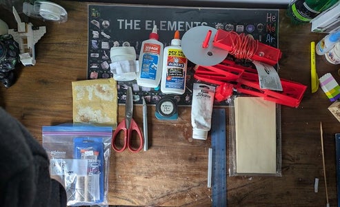

To build the rocket, you will need:
  1. Cardstock or balsawood
  2. Glue: wood glue or PVA glue (white glue)
  3. Cardboard tube
  4. Paint
  5. Decal (optional, I made my own from printer paper, it doesn't look the best, but it works)
  6. plastic straw for the launch rod, (or paper, but I found that paper is terrible for this)
To launch the rocket you will need:
  1. A launch pad.
  2. A rocket engine (I'm using a C6-7)
  3. Igniter

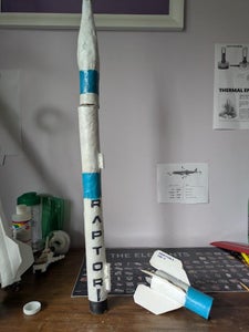

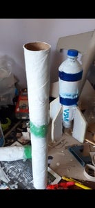

Step 1: The Fuselage
For the fuselage, I just found a cardboard tube lying around and covered it with long strips of packing paper and water solute wood glue in hopes that it would make it stronger (I don't think it did. The only thing it did was make it look uglier when painting).
Also, when I was first making this, I came up with the stupid idea of making a long centring ring to go in the fuselage to make it stronger. 🤣 I wasn't sure at the time how these engines worked. But when I realized my mistake, I took it out with a pair of pliers.

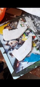

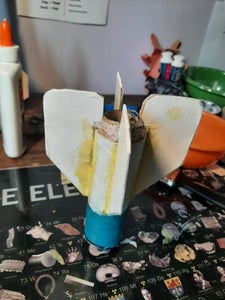

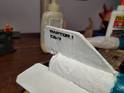

Step 2: Fins
The fins were made from 3 layers of cardstock and 2 pieces of paper on the outside edge. In the picture you see here I used cardboard, and I later found that cardstock is better for its lightweight and for being thinner.
I then placed the fin slots in the engine mount, gluing it into place and adding a filament of glue along the edges of them.

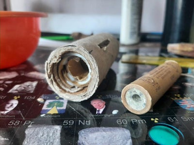

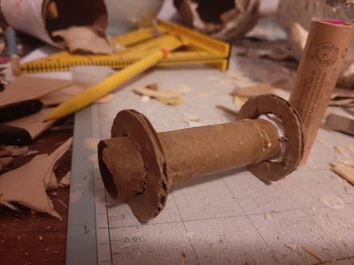

Step 3: Engine Mount
For the engine mount, I just took a bunch of cardboard tubes and glued them inside of each other with the engine hook until the engine fitted nice and snug, having a friction fit. This is kind of a bad idea because it is quite heavy and having done centering rings would have been a lot smarter. I then made the engine blocker to stop the engine from flying up the fuselage.

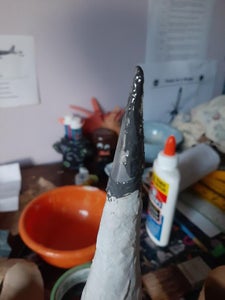

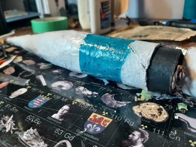

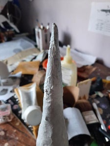

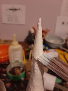

Step 4: Nose Cone
I made this rocket's nose cone out of papier mache. I don't really like this idea because it gives an ugly texture and rough surface, but I hope it works. To make the papier mache, I used water and flour.
Once the papier mache finished drying, I then made a little screw-on mechanism from a water bottle to make a payload bay for the rocket.

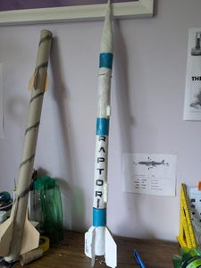

Step 5: Painting
For painting the rocket I used some acrylic paints, and added painter's tape for the blue stripes. The type of white I used to paint my rocket was Titanium white, I just found a tube laying around so I though I would use that.

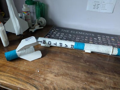

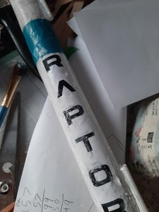

Step 6: Decals
So I wanted to add some decal, to really make it pop and look cool. But later I found that decals are not all that cheap, they come to about 50 to hundreds of dollars. So, instead, I made my own by making a design and printing it on my printer and it came out amazing! After it was printed, I cut it to shape and used some Elmer's white glue and water to apply it to the rocket, and then added a protective layer of gloss to it afterwards.

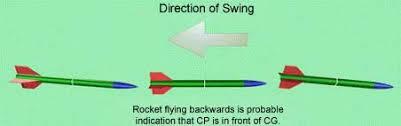

Step 7: Center of Gravity Test #1
I had to add some weight to the front of the nose cone, moving the weight slightly up near the nose cone, because it was not flying straight during some tests. I had to add a few pens and some sticky tack, to help make the rocket more stable.

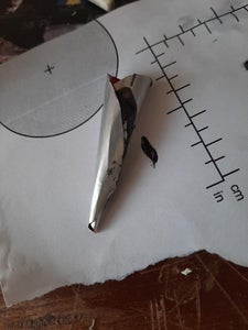

Step 8: Making It More Aerodynamic
I found that the tip of the nose cone flattened a bit (probably because of how many times I hit its nose on my roof and floor on some test flights), so I added an aluminum tip from a soda can, to help it push through the air better. To do this, you will first need a soda can and a hobby knife (or a pair of scissors). I first cut out a little square and then cut it to a circle shape so it would fit easily to the tip. After that, you now want to fold the metal to fit the nose cone and use epoxy to glue it into place. And of course paint it!
Step 9: Oh No...
So I put the rocket on a scale and I found that the rocket is about 2 pounds. This is bad. This was mainly because of the engine mount, which is about a pound - that's quite heavy. Because of this, I might have to remake the engine mount. Lighter. To do this I can't stuff a bunch of cardboard tubes into each other.

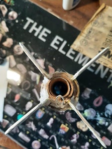

Step 10: Fixing My Stupid Mistake
I carefully took apart the fins (I had to use a combination of pliers) sliding the engine mount out. I then made a spiral tube for the engine to fit with some centering rings and glued it into place. I also had to replace the fins, so I cut some fins out of balsa wood sanding them down to an airfoil edge.

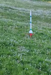

Step 12: Launch #2

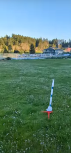

Success!! I was genuinely amazed by how well this rocket performed! Initially, I was worried it wouldn't fly or reach a significant altitude due to its weight, but it soared like a champ—Vrooooooooom! It was incredibly exciting!
The launch was loud, and after chasing after it, I was greeted by lots of smoke coming out of the airframe and a rather strong smell. The parachute ejected, but unfortunately, it didn’t deploy properly while in the air, which caused one of the fins to break off. Despite that, it was an incredibly fun project!
While it may not be the most visually stunning rocket you've ever seen, it certainly did a commendable job of demonstrating the principles of aerodynamic theory!
