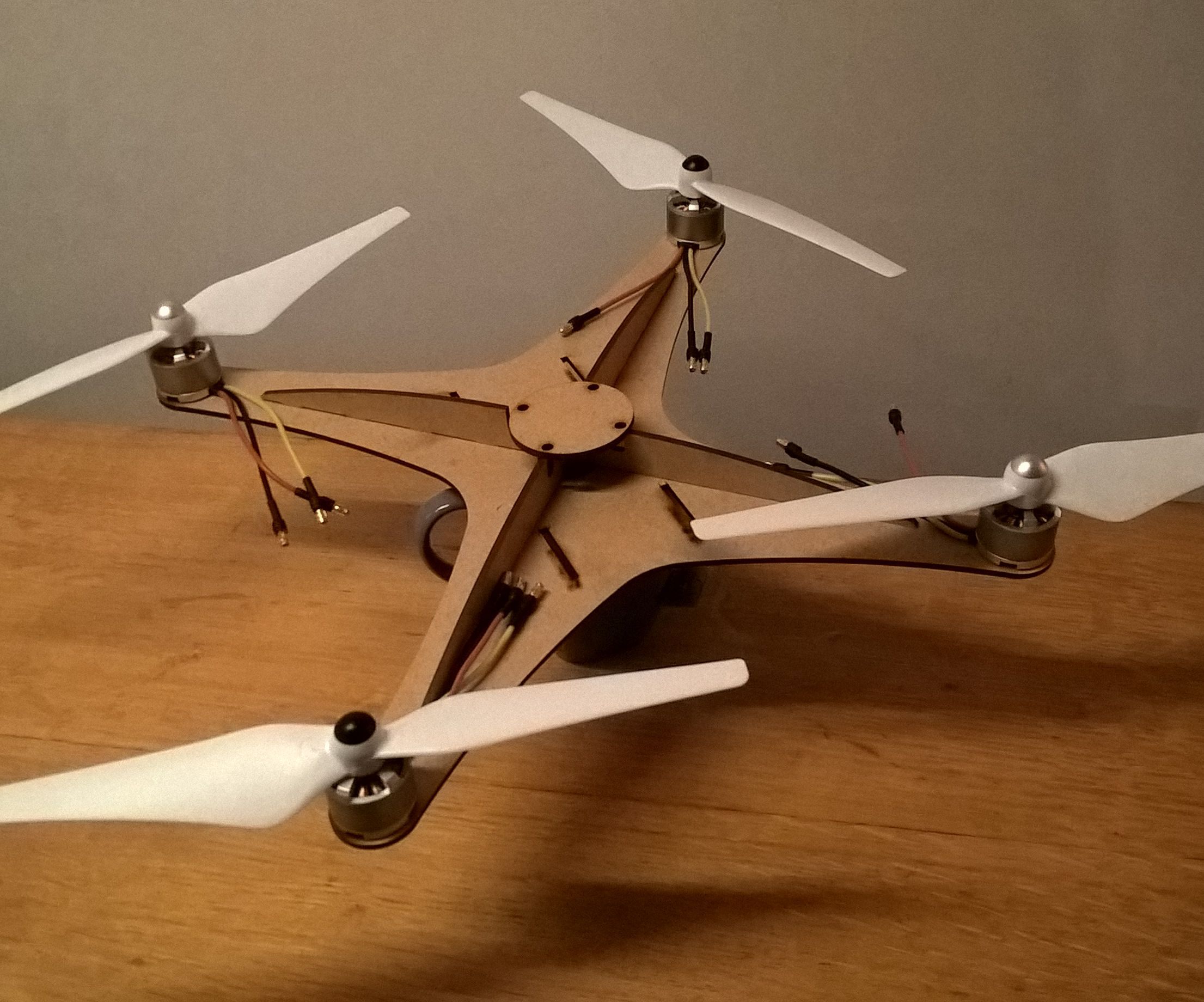

Step 2: Cutting the Racket
I just used a metal saw to cut the handle of the racket.
Step 3: Wooden Washers
I have built some washer to fix the motor on the stringing (With 3mm MDF see SVG file).
I finally did put one washer on each side of the stringing for the motors axis not to touch the racket strings.
I did use 3mm MDF you can do that by hand or like me using a laser cutting machine that will make an amazing job. 3D Printing can also be an option. You can also print the SVG on paper and glue it on some MDF that will be easier.
(the laser cutter i used is from a Public FabLab in Carrefour numérique de La Cité des Sciences et de l'industrie - LaVillette - Paris ).
Place the motors correctly for the propellers not to touch anything.
The controller (a Naze 32) will be placed in the center.
