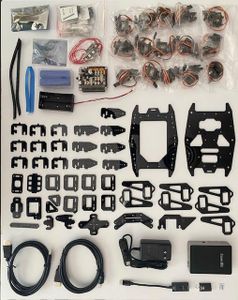

RaspClaws Kit Parts
  • Acrylic Body Plates
  • 1 x Robot HAT
  • 1 x Pi Camera
  • 1 x Camera Ribbon
  • 1 x mpu-6050
  • 4 x Car Lights
  • 4 x 3-Pin Wires
  • 1 x Battery Holder
  • 2 x 18650 Batteries
  • 1 x Ribbon
  • 15 x Servo Motors
  • Included Hardware
Raspberry Pi
  • 1 x Raspberry Pi 4 (RPi)
  • 1 x MicroSD
  • 1 x MicroSD Reader
  • 1 x USB-C Power Cable
  • 1 x HDMI Cable
Other
  • Screw Driver
  • Scissors
  • Zip Ties
  • Keyboard
  • Mouse
  • Monitor
  • Computer

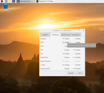

The first step to having your robot is preparing your Pi.
  1. Insert a microSD card preloaded with your OS into the RPi. The microSD in my kit was already ready, but you can use a microSD reader to write Raspbian to your SD card if needed
  2. Connect a keyboard and mouse to the RPi and a monitor via HDMI
  3. Connect the RPi to power and boot up. Install your OS (Raspbian recommended)
  4. After the RPi restarts, follow the on-screen directions to finish the initial setup
  5. Click on the raspberry icon in the top left, then Preferences -> Raspberry Pi Configuration
  6. Enable everything under Interfaces
  7. Connect your RPi to WiFi

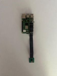

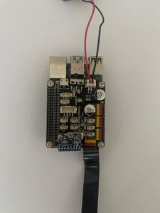

Step 3: Camera and HAT
Need:
  • 1 x Camera
  • 1 x Camera Ribbon
  • 1 x RPi
  • 1 x Robot HAT
  • 4 x M2.5*4 Screws
  • 4 x M2.5*14 Copper Standoffs
  • 4 x M2.5*10+6 Copper Standoffs
This is the first step in actual robot assembly.
  1. Connect the camera ribbon to the camera, then to the RPi. There's a black latch that can be pulled on both to connect the ribbon
  2. Attach the copper standoffs to the RPi. The M2.5*10+6 standoffs go through the bottom, and the other standoffs attach from the top
  3. Use the screws to attach the Robot HAT to the standoffs on top of the RPi

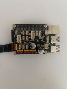

Step 4: Driver Board and Batteries
Need:
  • 1 x Ribbon
  • 1 x mpu-6050
  • 2 x M2.5*4 Screws
  • 1 x M2.5*11 Copper Standoff
Next, we'll get the Pi ready to debug the servos. Ensure the HAT switch is turned off before messing with the batteries.
  1. Attach the copper standoff on top of the opening in the HAT. Screw in from the bottom of the opening
  2. Use another screw to connect the mpu to the standoff (bottom of Image 2)
  3. Connect the battery holder to the HAT
  4. Place the batteries into the holder using the ribbon to make it easier to remove them later. I double-wrapped the first battery and then put the ribbon under the second

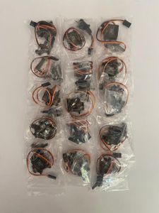

Step 5: Debug Servos
Need:
  • 15 x Servos
  • Configured RPi
This next step isn't constructive, but it's very important. Your robot can't function correctly without proper alignment.
  1. Connect each motor to the HAT. Ensure the wires' colors align with those on the pins
  2. Turn the HAT switch on. After about a minute, a Pi that is properly set up will run a program that sets all the motors to their center alignment

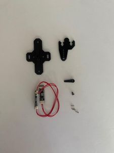

Step 7: Miscellaneous Plates
Need:
  • 2 x Car Lights
  • 1 x Single Servo Rockers
  • 1 x M1.7*6*6 Screws
  • 4 x M1.4*6 Screws
  • Acrylic Plates Shown
Next up is getting a few pieces ready to use later.
  1. Affix the rocker to the plate with the M1.7*6*6 screw as demonstrated in Image 2
  2. Secure car lights to either end of the t-shaped plate from the previous step. This takes the 4 M1.4*6 screws

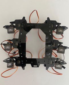

Step 10: Right Legs
Need:
  • 6 x Servos
  • 12 x M2*8 Screws
  • 12 x M2 Nuts
  • 3 x Single Servo Rockers
  • 3 x M1.7*6*6 Screws
  • 9 x M3*10 Screws
  • 9 x M3 Nuts
  • 3 x M2.5*8 Screw
You should be used to making legs by now. The right legs follow the same directions as the left with the parts oriented differently.
  1. Follow the same directions used to make the left legs, except flip the servos and reverse the acrylic plates
  2. Repeat for a total of 3 right legs. Image 1 serves as a guide for orientation

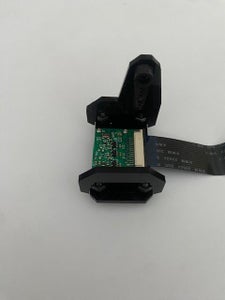

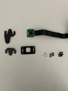

Step 11: Camera -> Plate
Need:
  • 1 x Pi Camera
  • 4 x M1.4x*6 Screws
  • 4 x M3*10 Screws
  • 4 x M3 Nuts
  • Acrylic Plates Shown (one from Step 7)
Now we can begin prepping the camera to be mounted.
  1. With 4 M1.4x*6 screws, fix the camera to the plate shown in Image 2
  2. Fasten the other two plates to the ends of the camera using 2 M3*10 screws and 2 nuts each. Again, the nuts go into gaps between the plates

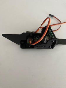

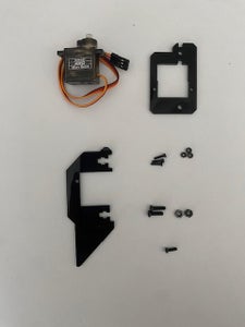

Step 12: Servo -> Camera
Need:
  • 2 x Servo
  • 3 x M2*8 Screws
  • 3 x M2 Nuts
  • 2 x M3*10 Screws
  • 2 x M3 Nuts
  • 1 x M2.5*8 Screw
  • Camera build from the previous step
This step attaches motors to the camera, making it ready to be mounted.
  1. Take 1 motor and attach it to the square-shaped plate using 2 M2*8 screws and 2 M2 nuts as seen in Image 2
  2. Attach another motor to the other plate with 1 M2*8 screw and 1 M2 nut like Image 3
  3. Place the 2nd plate on top of the 1st and secure with 2 x M3*10 screws and 2 M3 nuts. Refer to Image 4 for orientation
  4. Take the motor from the 2nd plate and connect it to the rocker attached to the camera. Secure the motor with 1 M2.5*8 screw. Again, refer to Image 4 for orientation

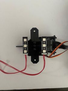

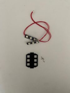

Step 13: Lights
Need:
  • 2 x Car Lights
  • 4 x M1.4*6 Screws
  • Acrylic Plate Shown
You might need a breather, so here's a light step for a part that'll be attached later.
  1. Place the lights into the openings of the acrylic plate shown
  2. Attach using 2 screws per light

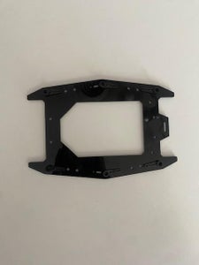

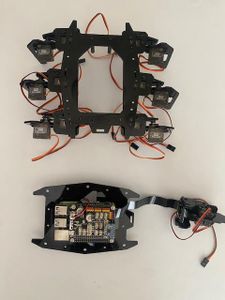

Step 14: Attach Pi and Battery Holder
Need:
  • 1 x Prepared RPi
  • 2 x M3*8 Screws
  • 2 x M3 Nuts
  • 4 x M2.5*8 Screws
  • Acrylic Plate shown

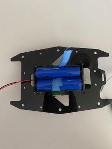

We're finally doing some more work on the RaspClaws body.
  1. Remove the batteries from the holder. Attach the holder to the plate with 2 M3*8 screws and 2 M3 nuts
  2. Reattach the batteries the same way you did in Step 4, ribbon and all
  3. Affix the RPi to the reverse side of the plate using 4 M2.5*8 screws that go into the open copper standoffs on the RPi

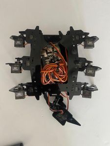

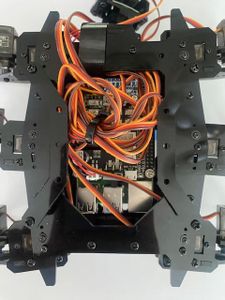

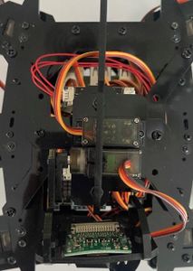

Step 16: Wire Servos
Need:
  • Body Build
  • RPi Build
  • 1 x Zip Tie
Now, we're connecting the two largest parts of our build, starting with wiring.
  1. Wire all servos to the robot HAT. Refer to Image 2 for the proper pin for each motor
  2. Connect your lights to the HAT. The incoming wire should always connect to the side of the light with a white bar
  3. Turn the RPi on and make sure one more time that your servos are oriented correctly
  4. Organize your wires however you'd like. I wrapped mine in a Zip Tie

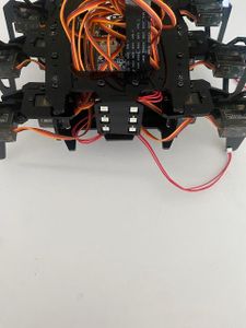

Step 17: Attach Top Plate
Need:
  • 4 x M4*40 Nylon Standoffs
  • 12 x M3*8 Screws
  • Rectangle Car Light Plate (from Step 13)
Following that, we can mount the leg plate onto the RPi plate.
  1. Connect 2 nylon standoffs to the right side and 2 nylon standoffs to the left side of the leg plate, similar to Step 15. Each standoff goes directly between two legs (Leg 1 -> Standoff -> Leg 2 -> Standoff -> Leg 3)
  2. Place the car light into the slots provided on the front side of the plates
  3. Line the standoffs up with the RPi plate and secure using 8 screws; 4 for the new standoffs and 4 for the ones from Step 15. The RPi should be face-up

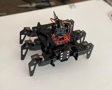

Step 20: DONE
Your RaspClaws is ready to run!
Adeept provides a web page for controlling your robot using your keyboard. Enter "[PI_IP_ADDRESS]:5000" into any browser to reach the page.
Ex) 123.456.7.890:5000
