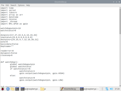

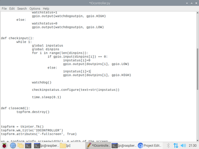

Step 15: Raspberry Pi Python Programming

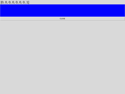

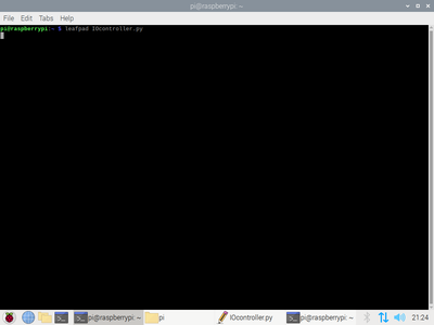

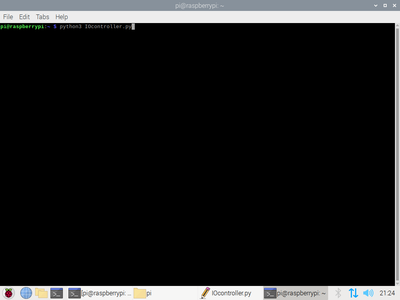

I use python to develop the program. Use leafpad for programming. In the terminal type leafpad IOcontroller.py. This open a new file in the dir. Compile the program, the program contain lot of small functions. For Watch dog a small function is available at each cycle this function called, so if program hanged to closed then it switch off the all the output. Currently i program to show how it works so if a pin is input is read then a output pin is trigger. If progam closed then the watch dog Attiny85 close the relay. After complete the program In terminal type python3 IOcontroller.py, this run the program it show the visual of which pin is read in the display form and the out put pin trigger is visual in the relay module. See the next video in action.

1) When the program on the watch dog relay ON.
2) When the input signal is sense then the output realy ON and Off when input remove.
3) When input is sense and the output relay is ON, at that time when program close with in few seconds all the relay switch off.
