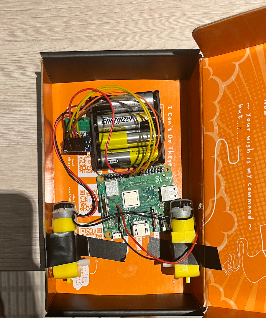

Step 2: Assembling the Motors and Board
You will need
  • Motorboard
  • Raspberry PI
  • DC Motors
  • Soldier and wires (Optional)
Connect Motor Controller to Raspberry PI
The instructions on a specific motor board should usually be in the manual.
Soldering Wires to Motors (Optional)
1) Strip the ends of the wires which you are going to solder
2) Remove the plastic clip from the motor to make soldering to the contacts more simple
3) Solder the wires to each of the terminals on the motor. It doesn’t matter which wire goes to which terminal. The reattach the plastic clips.
4) Trim the tips of the wires to ensure they do not touch the metal casing of the motor. It’s also a good idea to wrap the ends of the motors in tape, to stop the soldered joints from breaking.
Connect the motors to the board
You will need to connect the motors to the board. For this you will require a small screwdriver.
1) Insert the wires into the slots on the motorboard
2) Screw the wire slots back into the motorboard
3) Repeat the process for the battery slots.
Connect Motor Board To raspberry Pi using the cables using the cables and setting them to the matching pins from your instruction manual.
Step 3: Setting Up the Buggy and Programming
Setting up the chasis
1) Place your motors in the chasis
2) Stick a pencil at the end of your boxes to create holes where the motor will stick in aligned up to where you put your motors.
3) Stick the motors to the box using adhesive tape
4) Once motors are secure through the holes, attach the wheels to the white tips of the motors.
5) Screw a ball caster to the bottom of the box to act as a third wheel (Optional)
Once you are finished you can program the motors to move around using mu on your raspberry PI. Tutorial is on raspberry pi site.Link 2
