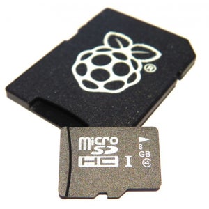

Step 2: Setting Up Your SD Card
If you are going to buy (or have) an SD card preinstalled with the OS, skip this step.
In this step I,ll show you how to install the NOOBS(New Out Of the BoxSoftware) on the SD card. If your computer has an SD card slot,then go right ahead and insert your SD card. If not you'll need to use your SD card reader.
Now head to http://www.raspberrypi.org/downloads and download the OS of your choice. Once it is downloaded, Extract it, and then use Win32DiskImager to image it to the SD card.

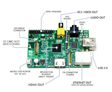

Step 3: Connecting Raspberry PI.
Now we are ready to connect everything to the raspberry pi. First we must put the SD card in, then connect the HDMI lead to your television or monitor.Now, connect the keyboard and mouse to the USB ports and the Ethernet port to your internet router or network. If you don't plan to use your Raspberry PI near your router,you can use a compatible WI-FI dongle.
PLUGGING IN YOUR RASPBERRY PI
  1. Before you plug anything into your Raspberry Pi, make sure that you have all the equipment listed above to hand. Then follow these instructions: Begin by slotting your SD card into the SD card slot on the Raspberry Pi, which will only fit one way.
  2. Next, plug in your USB keyboard and Mouse into the USB slots on the Raspberry Pi.
  3. Make sure that your monitor or TV is turned on, and that you have selected the right input (e.g. HDMI 1, DVI, etc)
  4. Then connect your HDMI cable from your Raspberry Pi to your monitor or TV.If you intend to connect your Raspberry Pi to the internet, plug in an ethernet cable into the ethernet port next to the USB ports, otherwise skip this step.
  5. When you are happy that you have plugged in all the cables and SD card required, finally plug in the micro usb power supply. This action will turn on and boot your Raspberry Pi.

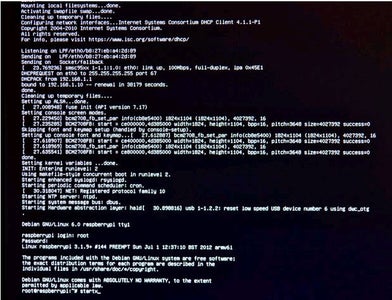

Step 4: Raspberry Pi-First Boot
First Boot
Connect the power, and after a few moments, the NOOBS environment starts up and presents you with all the different operating systems you can install on your raspberry pi. In most cases you should use Raspbian, so select it and click "Install". This will begin a process that will install Raspbian on your SD card - it will take around 30 minutes. Once it's complete, click "OK" and the PI will reboot, ultimately presenting a configuration menu, here you can change whatever settings you want, as long as you know what your doing. All being well, you raspberry pi will reboot into desktop view that, on the surface at least, is pretty familiar. At the bottom-left you'll see the equivalent of Windows 7's Start button, for accessing the software that is already pre-installed on the raspberry pi. Next to the start button is an icon that launches the File Manager, which works in a similar way to the Windows File Explorer. You'll also notice an icon labelled "LXTerminal",which, when double-clicked, launches a window containing the text pi@raspberrypi in green at the top left. We'll use this window to type various commands - don't worry, you'll only ever need to learn a few.
