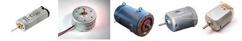

When you hook a dc motor up to {+} wire on one lead and {-} wire on the other lead, the motor turns a certain direction. When you switch the wires to other leads, the motor turns the other direction. But how do we "electronically" switch the electric polarity using circuits. ANSWER: H-Bridge.
The circuits for H-Bridges are non-trivial for the beginner. The L298N module is a simple ready to rock and roll "dual" H-bridge circuit board. That means you have the ability to control TWO motors in either direction.

The power to your motor needs to match. The motors we have are 6V DC hobby motors. If you're building something for real rather than just a quick learning tutorial like this one. Make sure you match you power drive to the motor requirements. Every motor needs different drive voltages. If you have less voltage than the motor needs then the motor will be under powered and may not turn what you want or might burn your power supply out, or worst start melting stuff. If your power supply is too high like for example you put 9 or 12 volts into a 6 volt motor, then the motor will turn really fast and hard. You see people hack their kids toy race cars with bigger batteries, the cars go fast and have a ton more power than the default design. These tricks always come at a costs for safety, reliability, and component breaking (melting, fires etc).
In our simple getting a motor to turn tutorial, a 5vDC old phone charger will suffice to drive a 6v motor, it's not optimum but it will work for a free spinning motor.
If the motor has torque or load in excessive the electrical power capabilities of the power supply the motor will likely stall. Go read about motor sizing, stalling, and hacking motors as your next learning adventure after this basic introduction.
